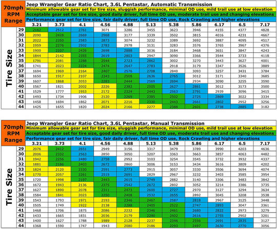

I got a 2012 jku rubicon 6 spd I'm going to run 35s what gearing should I go with. I know I could run the 4.10s but I don't want to lose my craw ratio. I would like the gearing on road with 4.10s and 35s but I think it will be alittle fast going over rocks.

Gear chart shows 4.56 will return it to slightly lower gearing than stock ratio with 35s. I'm waiting for some one to chime in that has the same situation I do not want to lose my crawl ratio but I don't want to much more either.

The charts say the 3.6 on 35s should have a minimum 4:10 and a max 4:56. I am considering 4:56 but need to know more about what Im getting into before I make the swap.
1) I want to know what it will do to my mpg's since this is my daily driver
2) I want to know what 4:56's will do to my 1st gear. Right now im getting about 15 mph out of it. PS - You can start from a dead stop in 2nd gear without stalling.
I hear that 4:56's are hard to find but I would imagine this will change in the future as 4:56 is an odd setup for the older jeeps. The pentastar will change that I beleive.
Next up from 4:56 is 4:88. I have no interest in the 4:88's as it seems to be the most popular gear for the 07-11 JK's.

If you have an auto trans 3:73s are considered minimal. 4:10's and 4:56's are considered optimal for highway driving. Im surprised you are not complaining.
