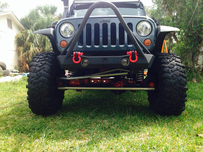

I went with 5:38s with my 37s turned it into a beast
