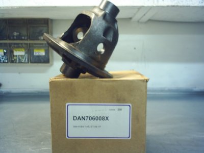

Ok, sorry to ask a stupid question but I have been wondering this for a while. What is a carrier? What does it look like? A pic would be nice. How much do they cost and where do you buy one. I have 3.21 gears and plan on regearing next year, and wouild like to know something before I do it so I dont sound like an idiot when I am talking to the shop.

Standard Open Carrier, Dana 30, 3.73+ up ratios. This is the carrier you'd need for the Dana 30 if you have 3.21's and plan on going to 3.73, 4.10, 4.56 etc etc. of course if you plan on adding a locker or a posi up front you wont need this.
