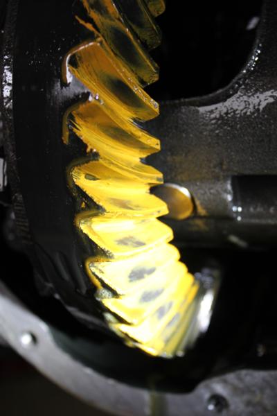

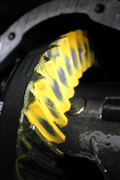

Well the good news is the gears are set correctly and wearing perfect. The great news is Rebel Offroad is awesome and I am lucky to live near by.

Basically, a combination of them breaking in and the fact 5.13's are a bit noisier than the stock 3.73's. The tolerances, torques and wear patterns were good to go.
Let me say that the noise was heard with the radio off, heater fan off, and me paying close attention. There was no change in the noise on decell or accell, and as the pics show everything is working well.
