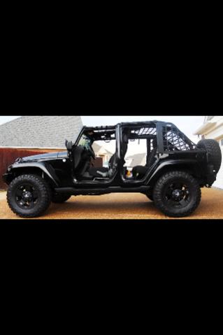

I have a 2007 JKU, with stock gears, 2.5 rough country lift & 18" wheels wrapped in 35" trail grapplers & a flowmaster super 44 off road exhaust. My questions is what gears should I consider swapping to?
