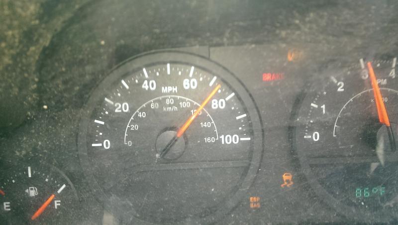

I have 35s & 4.88s 2door 3.8 manual this picture is in 6th gear if that helps
You can jack the rear end up, both tires. Turn the tire and count the drive shaft rotations

The picture posted before wont help. Its from a JK with a 3.8, and a different transmission with a different overdrive ratio.
This picture might help. Its from my Jeep, with a 3.6, auto trans, 4.56 gears, and 35" Toyo MT tires.
If I were placing bets, I would bet you have 4.88 gears.

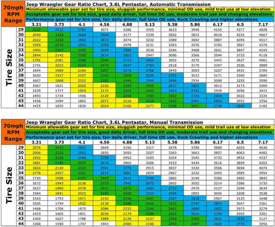

Allow me to place a helpful picture
If ya cant see it or download it here is the page Google gave up
http://www.tnjeeps.com/topic/1052-je...earing-charts/

The 6 speed is the same in both the 3.6 and 3.8. His rpms are to high to have 4.88. The big question though is if his speedo is calibrated. If its not then your not going to tell by using the speed and rpm.
Attachment 579652
What sort of black magic is this. Brake on, ~74 mph?!
Old Oct 13, 2014 | 02:47 PM
stagedtrip's Avatar
Posts: 3,641
Likes: 10
From: idaho
Other than my pledge to the dark Prince....
I have a bad wheel sensor or something that makes my dash light up
