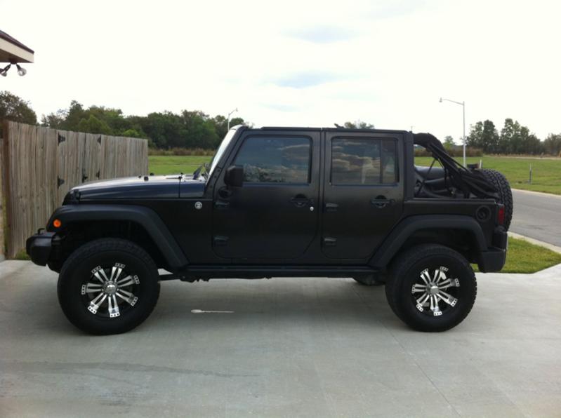

I also run the RC 3.5 lift and I honestly love it. People give RC all sorts of crap but it rides better than stock and is incredibly complete for $500. Wheeled it pretty hard over the weekend and it's amazing. You'll be happy with it. I have them on 35's but also ran on 33's for awhile.
Looks OK with 33's and aftermarket bumper/winch weight...
Looks very good with 35's...

Awesome thanks for all the info. Seems like 5.13 is the way to go. Im only considering the 3.5 lift from rc because it's a good damn price and it is a dd. I have a little girl and I don't want to be crawling up trying to get her in car seat. Here is a pic. I am getting either the smittybilt xrc front and rear bumpers or body armor ones. O need a tire carrier to get the bigger tire off and those look the best I think.
