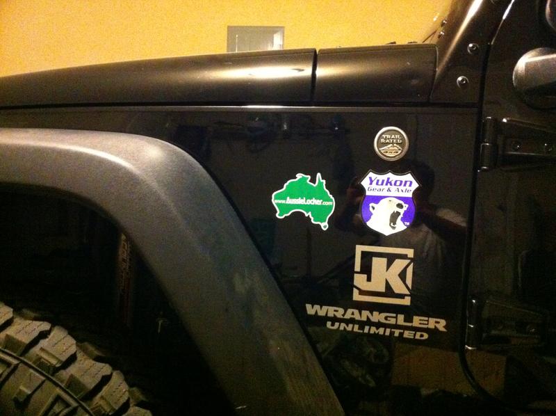

And, since
Here is a picture of the nifty sticker you'll get with those Yukon gears:
