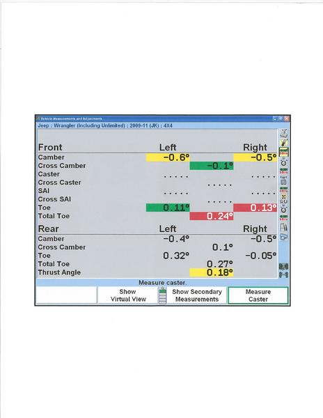

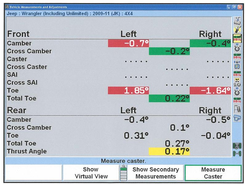

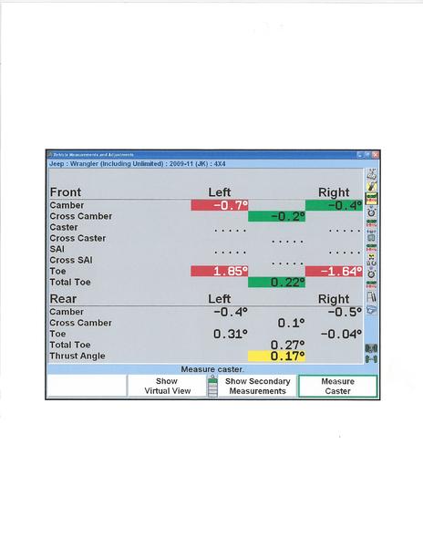

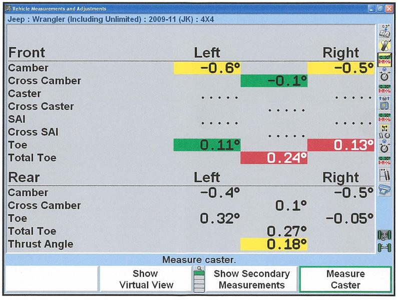

Hey - Had the alignment done at the NTB in Greentree. Seemed like pretty good guys and were into Jeeps and off-roading. I attached the before and after results below. Feels better at higher speed and turning now but maybe thats in my head! Not a lot they can adjust on a stock jeep. Let me know what you think.

These might be easier to read...

I guess I have to assume the pic taken at 1:03 PM is first.
The toe isn't that far off and is only a wear factor. .02 degrees is just out of spec.
The camber is fixed on Jeep solid axles and not adjustable from my understanding.
Caster not available. if this is out you will get a "pull".

I believe from what they told me the pic taken at 1:03 was first and the second one (second one on screen) with the toe more in spec was after correction. He told me that he had to adjust the toe to get it into spec. I was thinking it might have been from lift, tires and pretty hard wheeling a couple weeks ago that it was out. Feels pretty good now - when I would change lanes specially to the right at speed it would feel funny. I mentioned to the guy that the steering might have been just a little off center and kind of pulling to the right but he said after he corrected the toe the steering was fine, I'm not sure if hes right or wrong but it does fell more centered - if it was off before it was just a little off.. He seemed to know about Jeeps and ZJ's and said if I had any problems or concerns to bring it back no charge.
