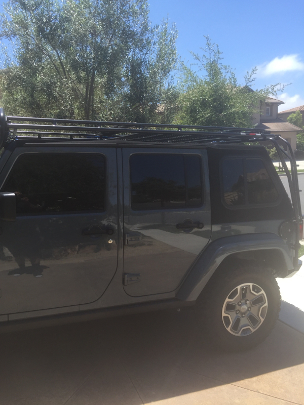

Yes. They do make one for a
Slant back. But I have a hardtop also so not an option for me. Will post pics. One thing u do need to know is that u will have to restrict the rear window from opening all the way up cuz it will hit the ladders.

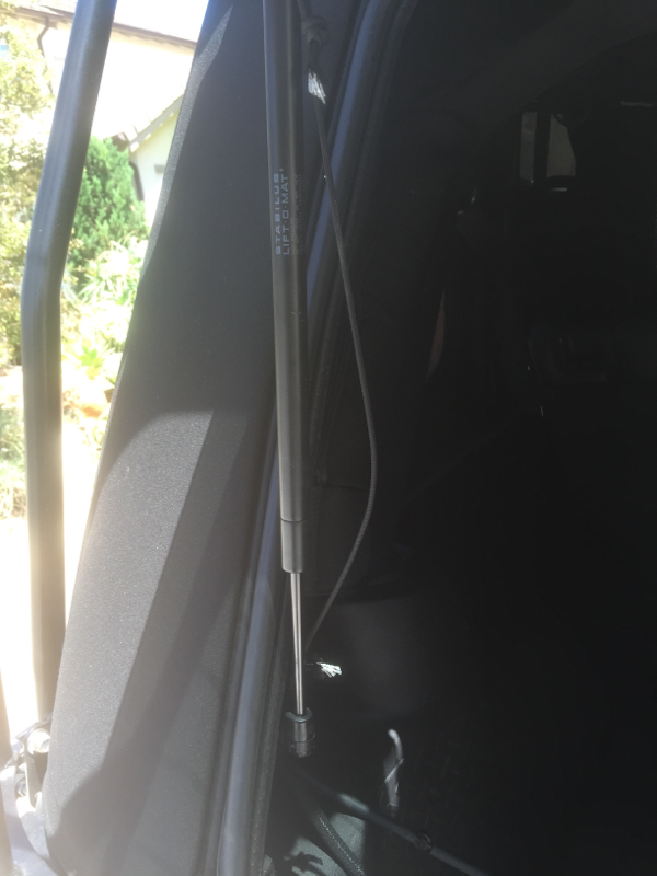

This is how I restricted the back glass. Black parachute line attached to window pneumatic opening mounts.
