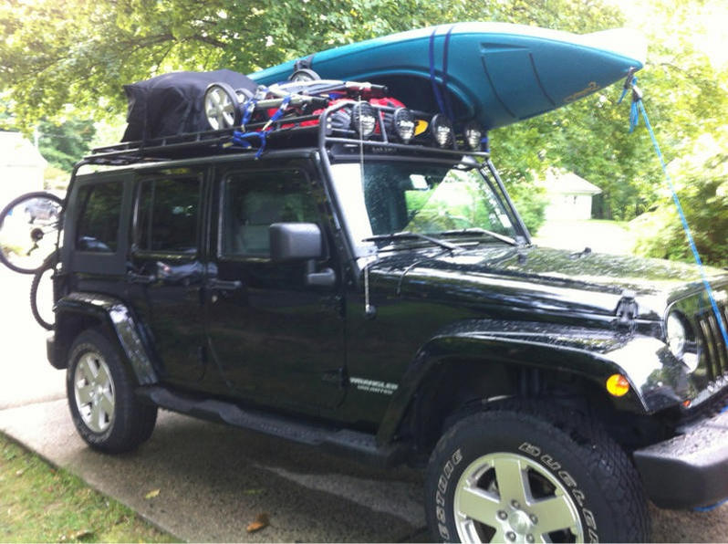

I have used a Thule kayak stacker on my gobi rack, and could check that my ski rack fits, but
I had no problems with the stacker.
