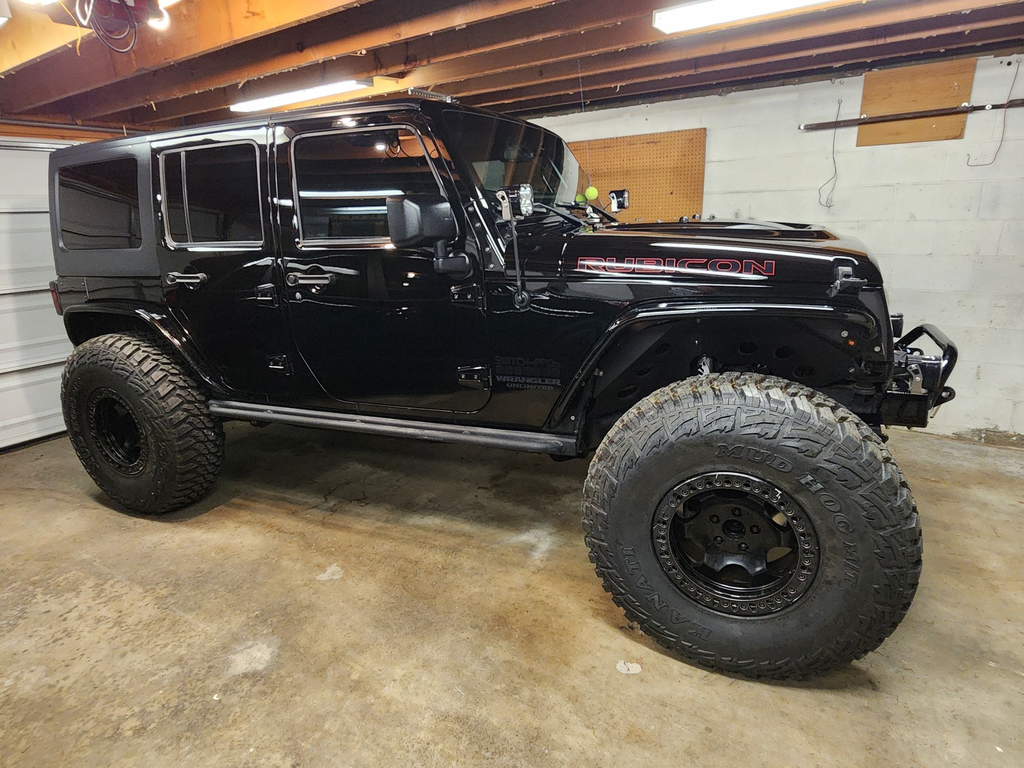

haven’t done the mods for stops and drop but the tires are on.
Old Dec 1, 2023 | 07:48 AM
Johnnyairtime's Avatar
Joined: Aug 2022
Posts: 17
From: Alpine, CA
That looks great!!!
Nice clearance above the tire too.
Have you finished adding bumpstop and did you leave that height or add to it??
I just put 39" Kanatis on yesterday, and want an inch more height to accomodate my inch more bumpstop I'll be adding. I have 4" coils too... but, it doesn't sit as high as yours.
