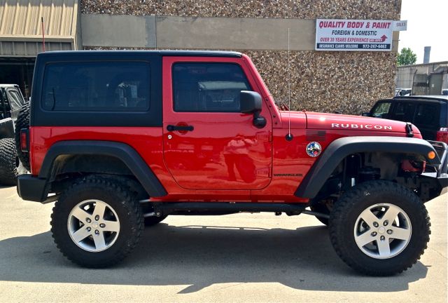

I am in this boat and am rowing hard and fast. Like afpilot82 said - save up and do it right.
I added a bit of armor (rails etc) then saved for the lift - I did a RK 3.5" and I have a 2012 2dr so I also added new
drive shafts for the build, at the same time I did C gussets and control arm skids and since it was all apart I added
RCV axle kit This is about as far as I got (new rims are in the garage waiting for shoes, I started down the wrong
path) - my next update will be rear bumper (doing LOD shorty with
carrier) - then I'll get new gears since mine is an auto and I have 4.10s, I'll add new HD rear axles at this time - then
I'll get new shoes. I figure it will take me about a year or so to get there but I think it is the right path.
This way I also get to wheel it and not worry about it along the way.
Looks a little "funky" with stock tires and all.... but its okay for now.

Originally Posted by Matthewd5
I have read tons of great threads about lifts and tire/wheel upgrades & choices...
How does one go from stock to 35's in steps?
I mean to do it right I have to jack it up, add the new bigger tires and either spacers or new wheels, and then I have to buy a new bumper/tire carrier to handle the 35" spare...
Do I do the lift and save up till I can do the tires plus $$$ bumper/tire carrier?
On top of all that I have the 3.21 gears...
Part of me is tempted to just get some really good 33" tires and do a leveler or budget bump and wheel with that for a season and go bigger next year?
Matthew
Attachment 314572
My next step is the AEV armor set for the oil pan, tranny and drive shaft
Then probably save up for lift+tires+tire holder/rear bumper
I just want to go wheelin as much as I can with my local club so I have more info to base my build on, should make the decision tree a bit more informed as to the priorities in relation to where I'm gonna be Jeeping...
Matthew
