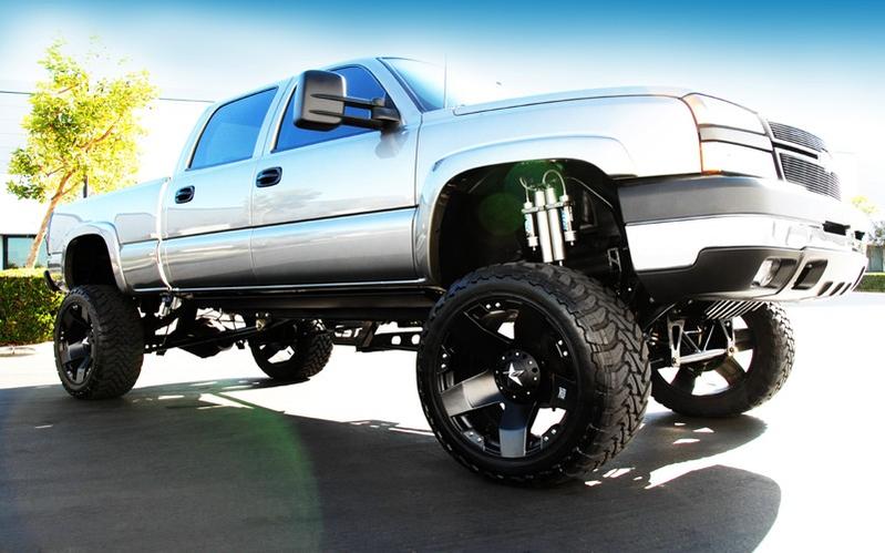

285/50/R20 converts to somewhere around a 31 x 11.50. That is a lot of wheel and very little rubber.
They should stick out a little bit.

This is a picture with 37/13.50/20 on 20x8.5 rockstars wheels you decide
