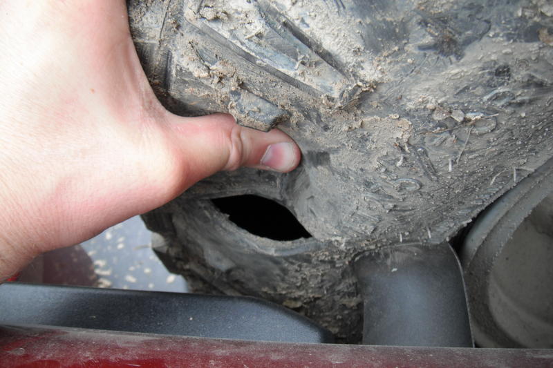

I have Duratracs "E" rated and they are awesome!!!!
Sure they are heavier .....but these things are unstoppable....i run about 32-35psi on the road and then air down to about 16-18psi offroad.
The "E" rating was the only available rating in my size tire....so you are probably in the same boat. honestly I would rather have the 10ply anyways....it's gonna hold up better against damage.
Here is what I did to my sidewall.......if I was running something else I am sure it would have been a lot bigger!

fyi....those load ranges and the corresponding ply are the tread plies. E range is 10 ply in the tread, which means it is much more puncture resistant than say, a C range. most sidewalls are 2 ply, regardless of load range, with a few (I believe the MT/R) being 3 ply. if you're looking for sidewall puncture resistance, look for a tire which has the thread extending partway down the sidewall, and/or check out the sidewall ply #.
