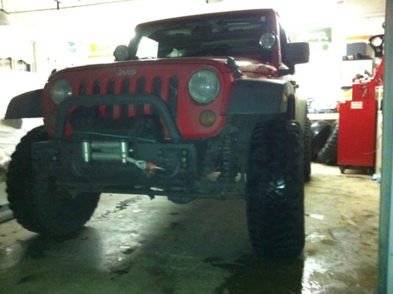

They are not directional (as per Goodyear). This is a poor photo of my MTR's with Kevlar. The tighter "highway" Pattern of the tread has been traditionally mounted toward the inside of the wheel (like mine). I have seen the tread mounted on the outside however for doing any climbing/digging, I'd think you'd want the tighter pattern on the inside.

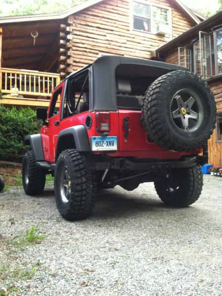

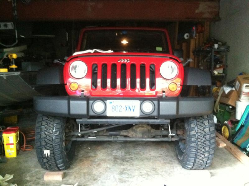

These tires say right on the sidewall "mount this side inward"..... "this side" being the side with the AT strip. They are an asymmetrical design but not a directional tire.
I do a 5 tire swap and this is how they are supposed to be mounted.
