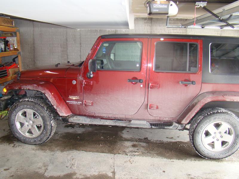

So my Teraflex spacer leveling kit came in a week ago and i finally had time to get it put on. Took 3.5 hours with only one 5 minute restroom break. I really like how the rake is gone! (pretty much anyhow). Only thing that would have made it easier is if the instructions told you to undo the rear track bar. Even with my 245 lbs standing on the lug studs we could not get enough rear droop to fit the springs back in without undoing the track bar. I have never posted pics on here before, so I am going to TRY putting the B4 and afters on here. I cant wait to throw some beefier meat under this thing now....
