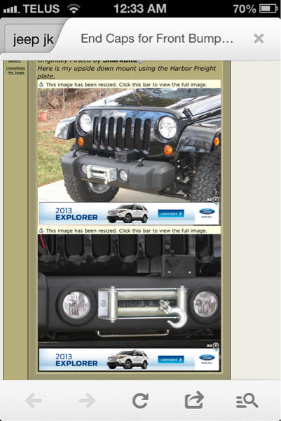

Mount it on factory? But really any bumper will work if you have a welder and some nice thick plate. Here is a picture of what I want to do.

Gman - thanks! I have a 2012. Is there someplace I can look that up?
FunkyMonkey - that looks pretty cool! Is that a standard bumper? I am not sure if my local dealer is that savvy based on our initial talks.
Cheers, Alice

Yupp that's the factory bumper modded. I want to this to my jeep but don't have a winch yet lol. Stole the picture from google.

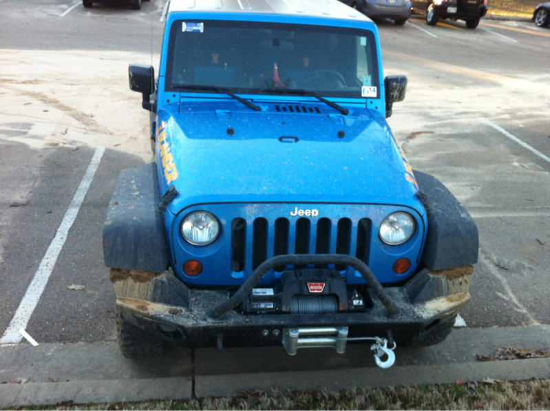

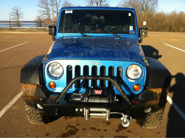

I have the Warn Elite Series Front Bumper and I love it! I have a 2010 Wrangler, so I did not have to worry about relocating the vacuum canister.
ID:	417795   Click image for larger version
