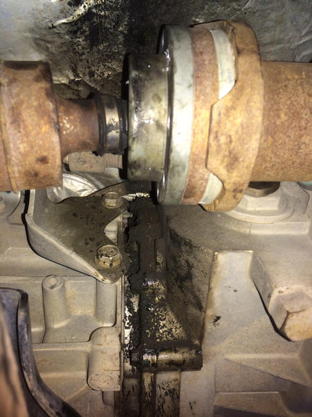

Then you've got some time. Mine was torn for over a year. Check your rzeppa joint. Is be willing to be that if you wheel your rig and disconnect, you've probably torn/worn it out, too. That's the one that is a ticking time bomb.
Bad rzeppa joint:

It was shortly after I installed my RK 3.5 mid arm kit and fox shocks. I ran out for a test. Disco'd and first ditch I passed over causing a decent amount of flex... torn. I guess it caught on something on the frame of the Jeep. What causes the rzeppa boot to tear? Does it catch on anything?

Excessive angle/stress.
The slip boot is torn hitting the crossover. Keep it clean .. Maybe a blast of fluid film to prevent rust.
Flex out the front end and see where the shaft hits.

Hitting the crossmember skid is common, you can trim it where the shaft hits or add some washers to lower it a bit. And when flexed, check the corner of your auto tranny pan. A few people have smacked the driveshaft into it hard enough to dent the corner or split the seal.
Or you could just buy a thinner aftermarket shaft.

Which with 3.5" of lift you definitely should do once that Rzeppa joint goes. It's not designed for those kinds of angles.
