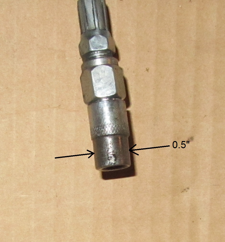

I turned down the diameter of the zerk fitting just a tad. It works fine.Click image for larger version

Trimming down the nozzle is a good idea. I don't have the issue with my Synergy's but my Alloys in the TJ have a funky fitting (that flush style)....so I shaved down a standard zerk to where I can grease it and then replace the flush fitting.

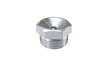

Presume this is the funky flush style that you're referencing?
That's what I have on my lowers....and what I use the needle for. I always seem to make a mess with the standard grease gun fitting, and found I was a lot cleaner with that needle fitting as it allows me to keep a good visual on the zerk itself. Also, too lazy to keep changing grease gun fittings back and forth.
Your flush fitting is more for this type of grease gun fitting:
I see you are having good luck with the needle fitting, but there is a good chance the needle will damage the ball and spring.
