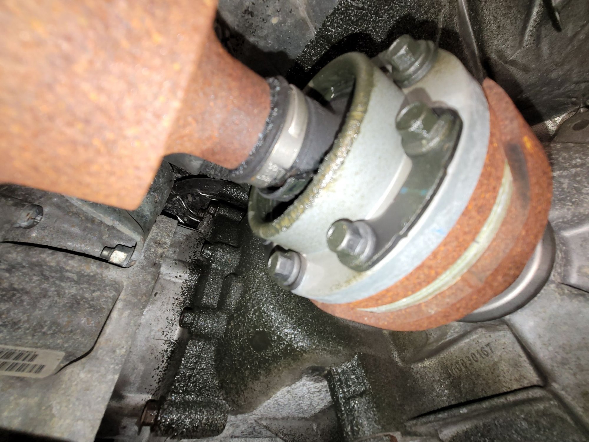

Evening Everyone, so I bought this 2016 Rubicon Hard Rock a couple of months ago off Vroom. Not sure what the previous owner had in terms of suspension/tire sizes but the only thing he didn't take off was the 5.13 gearing. He seemed to put everything back to stock and put 33 inch tires on to sell it.

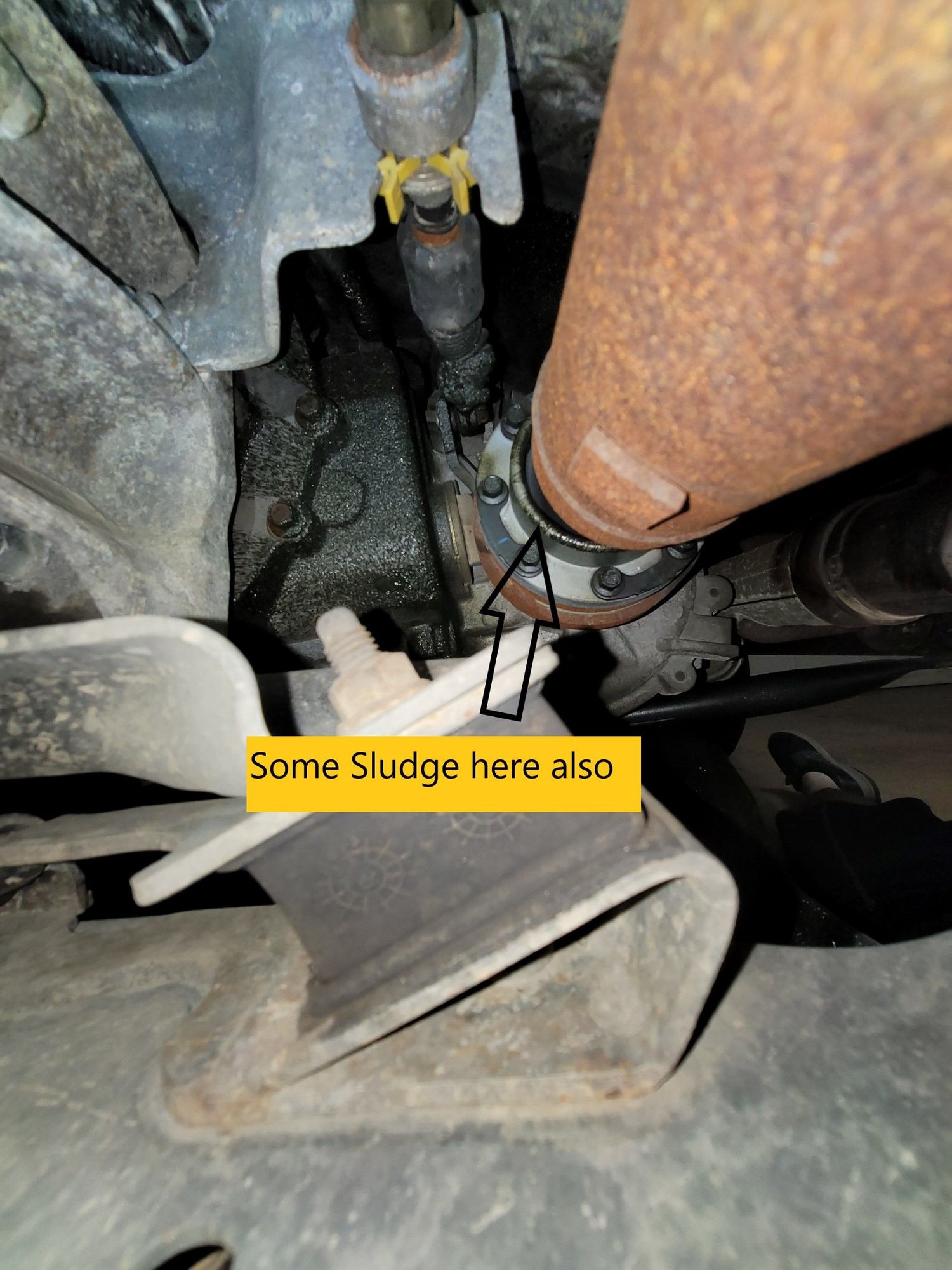

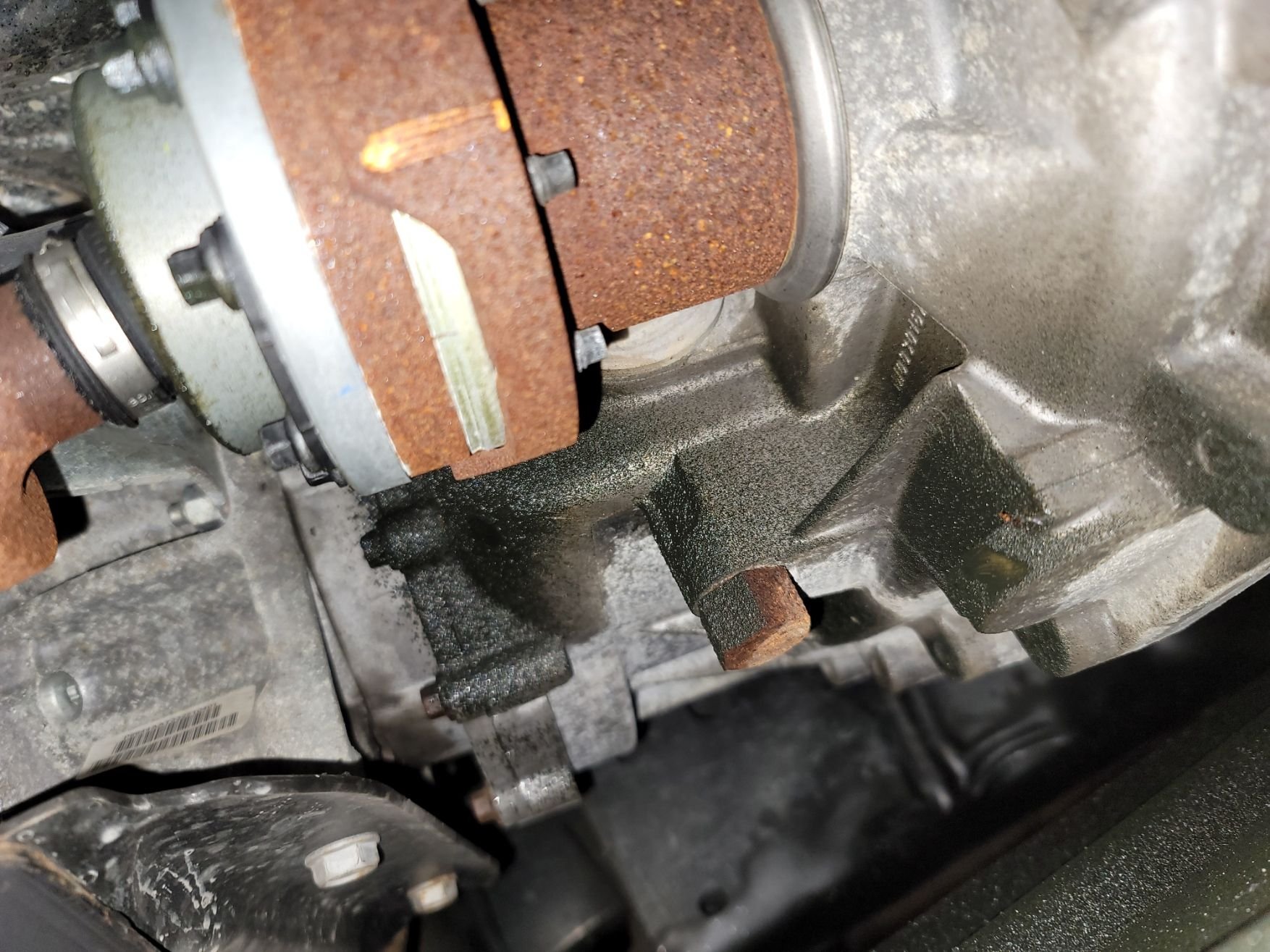

So as i was replacing the oil filter adapter housing i went under the vehicle to clean some of the oil and I am now seeing some green sludge around the driver side of the transfer case. Its on the splash guard and the heatshield and a little on the front drive shaft.
All visible fluids are red/pink. Coolant, wiper fluid, brake fluid, trans fluid, all some form of red or pink. I havent checked the transfer case fluid (and i am sort of a novice when it comes to drivetrain) to see if they put green in it. Only other lead someone mentioned was AC compressor oil/refrigerant but AC works perfectly and do those lines go back that far? Everything else is pretty darn clean.
Pics for reference.

So a common issue is that the boot protecting the CV joint on that driveshaft there at the TC will rip and spew grease. Often you see a big streak on the underside of the tub. It does seem like a mess right in the location of that joint, and you note "sludge" right there on the DS joint as well. You typically can't see the rip while installed, but if you rotatat the DS around and feel with your finger up there you should feel if it is ripped or not. I would inspect that, clean the mess, and monitor. I can't really make out that it is green in the picture. What is also interesting is in the 2nd picture, the area to the left of those two bolts is clean....as if what was making the mess was coming from the DS side and those bolt heads blocked some of it....though that could just be angles of the pictures.

Thanks for the reply, i see what you mean about the two bolts having one clean side, that angle is horizon level looking from front to back so your view is spot on. Ill see if I can find any good DIY guides on replacing these if that is the issue. (if you know of any please feel free to share!) Sometimes I like to look at DIYs to understand if it COULD be a potential cause or not. I have cleaned the area but ill go back out and see if I can feel any rip. Thanks for the input!

SO. As I was cleaning the splash pan and read your reply, I went back under.....you were SPOT ON. And i can see the tear clear as day.

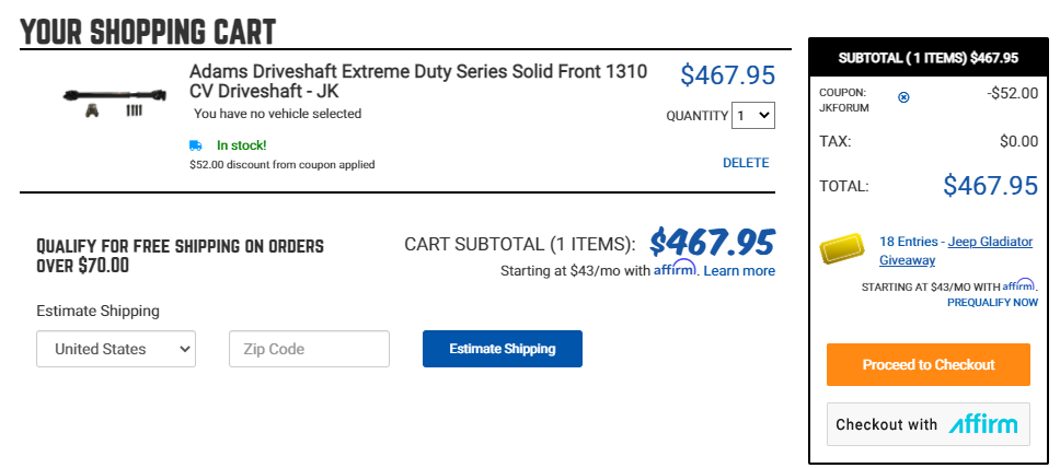

If you go the route of an aftermarket double cardan shaft you're in the $425-525 range. There's nothing fancy about driveshafts. Sometimes a local driveline shop is cheaper, sometimes buying off the shelf is cheaper. There are also a few upgrades and options when looking, like solid u-joints vs. greaseable, or mounting to the factory pinion flange vs a new yoke you have to install on the pinion (as mentioned). Here is an example of one from Northridge 4x4. This one mounts to the factory flange and has solid u-joints (though you still have to grease the centering joint from time to time to this is not "service-free", but none of them are -
https://www.northridge4x4.com/part/f...-cv-driveshaft
I would tell you not to just buy something cuz I or anyone else say "buy this". Look around at your options, price out a couple brands and make the best choice for your application. I have seen a few install that TF joint and it's been fine for them. The one benefit you get with an aftermarket front shaft is some additional clearance over your exhaust crossover as the shaft is a smaller diameter vs. factory.
***note the JKFORUM discount code in that snapshot above.
