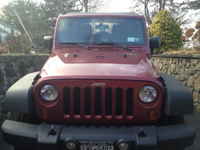

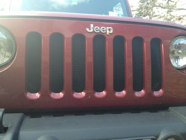

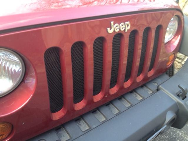

I did individual strips, because this partnered with 4 fasteners on each side allowed the GutterGuard to get pulled nice and snug all the way around each vent opening. I plasti dipped the gutter guard prior to installing as the left over stuff i had in the garage was silver.
If you do use individual strips, just get all the zip ties through and connected with a couple of clicks, then once they are all ready, tighten them down one at a time. Dont tighten each one as you go.
