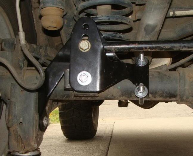

Originally Posted by PG-JKU
Actually now that I am not trying to look at pictures on my phone, it looks like the track bar bracket is already installed. The Teraflex barcket comes with an extra piece that gets C-clamped to the axle housing, and also has tabs for additional welding. This bracket that you installed does not have that, and the extra lever arm force from the longer bracket might have contributed to the failed welds.
There is a reason most people on this site stay away from Skyjacker.
If you weld it back, make sure you add some extra reinforcement gussets, or get a Teraflex bracket.
Here below you can see why the Teraflex bracket is stronger - bolted in two other places. (Photo is from another part of this site, but the same part is on my jeep)
Attachment 534042
Thnx for ur reply the teraflex looks better actually than the skyjacker there is a part for the support I didn't install but the picture u sent it looks much stronger than skyjacker bracket
I will reinforce it Thnx for ur help

Do I have to weld this part on the bracket

There are parts you didn't install? Hard to blame the parts then!
You would just replace the factory bracket with this part. Throw that other stuff away. It is a replacement weld on bracket with adjustable mounting location for different size lifts. I ran this back when I had a track bar.
Sent from my GT-P3113 using Tapatalk
Yes the bracket support I didnt install I ordered them now will install them as soon as I get them
