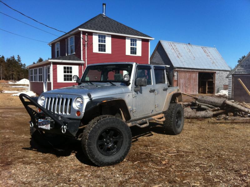

I just tapped that hole when I installed mine. I also didn't drill the pinch seam like they wanted. Didn't make sense to remove that much material that close together. They hold me (300 lbs) no problem.
I really like them, but the fit leaves alot to be desired. I had to draw my pinch seam in a few places to make them fit.
