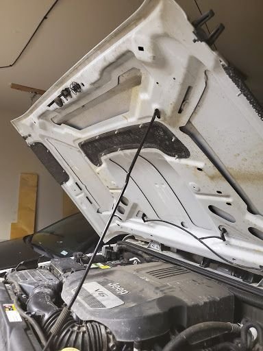

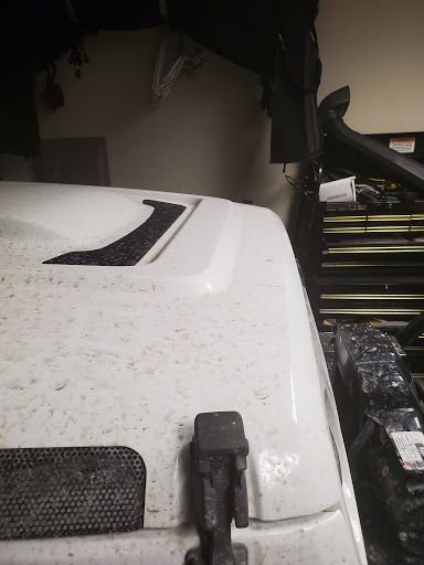

My buddy has an AEV jeep, and here is the underside of his hood. I am not positive, but I would think that the 10th anniversary and the Hard Rock hoods, and other similar hoods have some structural supports that will eat up the space you're wanting. Not sure what the TOTL hood looks like from underneath but I'm sure there are pics out there. I'm going to guess that you're not going to get the clearance you're looking for in the right area.
Although these hoods are a little different, I think the bumps are very similar in regard to position and size.
