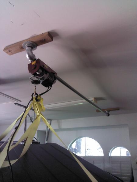

I made my own electrical for about$200. I've got to replace the straps as the ones I have are way too long. I mounted it on a 10' pipe so I can slide it between bays in my garage.
ID:	468916   Click image for larger version
