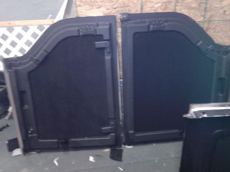

Finally finished

Looks good! Did you bedline and soundproof? More details would be nice.

Looks like it was carpeted. looks pretty good.

1/2" rmax insulation board
Rustoleum bedliner
Wally word carpet
3m 90 adhesive
1/4" foam insulation strips with self adhesive backs
Liquid nails
Loc tite for foam board
Cardboard for around back windows
Vodka
A lot of time
More vodka

That's beautiful. What is that? Velvet?

Just replacement carpet (from walmart) wrapped around 1/2" insulation board
