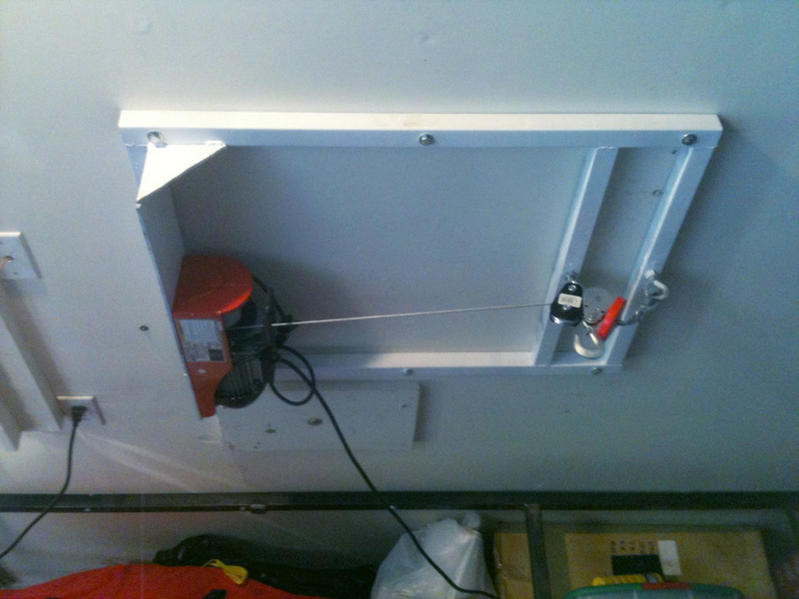

Built my own with electric hoist. Piece of cake to take off and put on.

You put your red stopper at the wrong spot it is to shut off the winch. That is what the rectangle is on your winch that the cable comes through.

Yep he's right the red stopper goes between the winch and the pulley to stop it from winding up too much. For those not paying attention when they're lifting! I installed one for my mother in law for her 2007 Sahara, it works great. Haven't got one for my 2007 Wrangler X yet.

I now have a 4:1 reduction in hoist speed. I can not put the red stop in line since it would have to got through all the pulleys. The reduction is to help keep the top from bouncing and flexing to much.

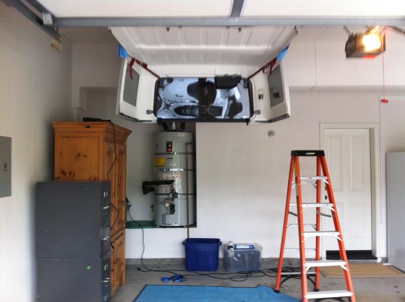

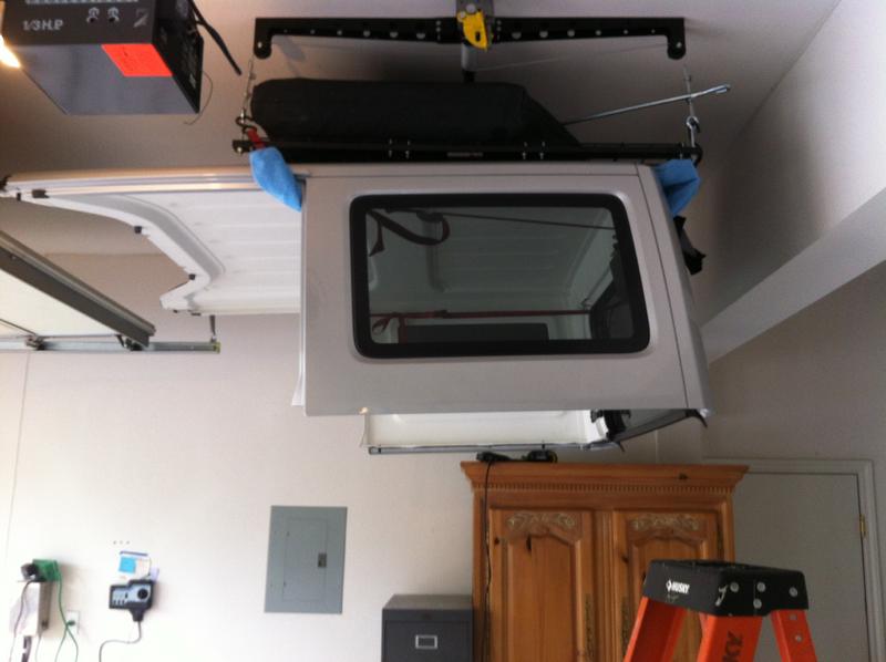

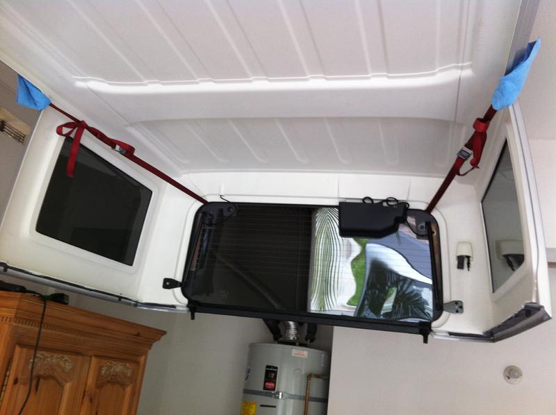

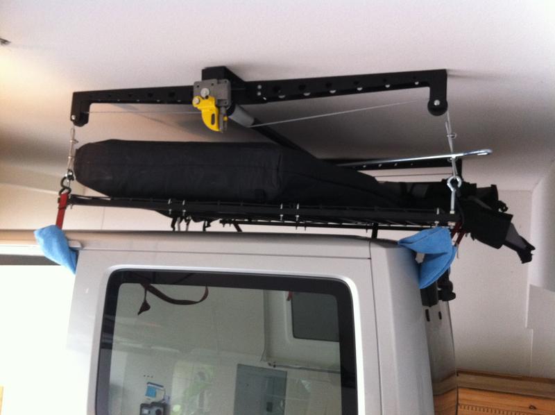

Default Installed the Racor system....
after seeing this thread a couple weeks ago. Wow this thing really works. I can drive the jeep underneath and just lift it right off. The top of the system allows storage for a bunch of extra stuff as well. I have my two freedom tops and some bikini tops act up there.
Highly recommended.
