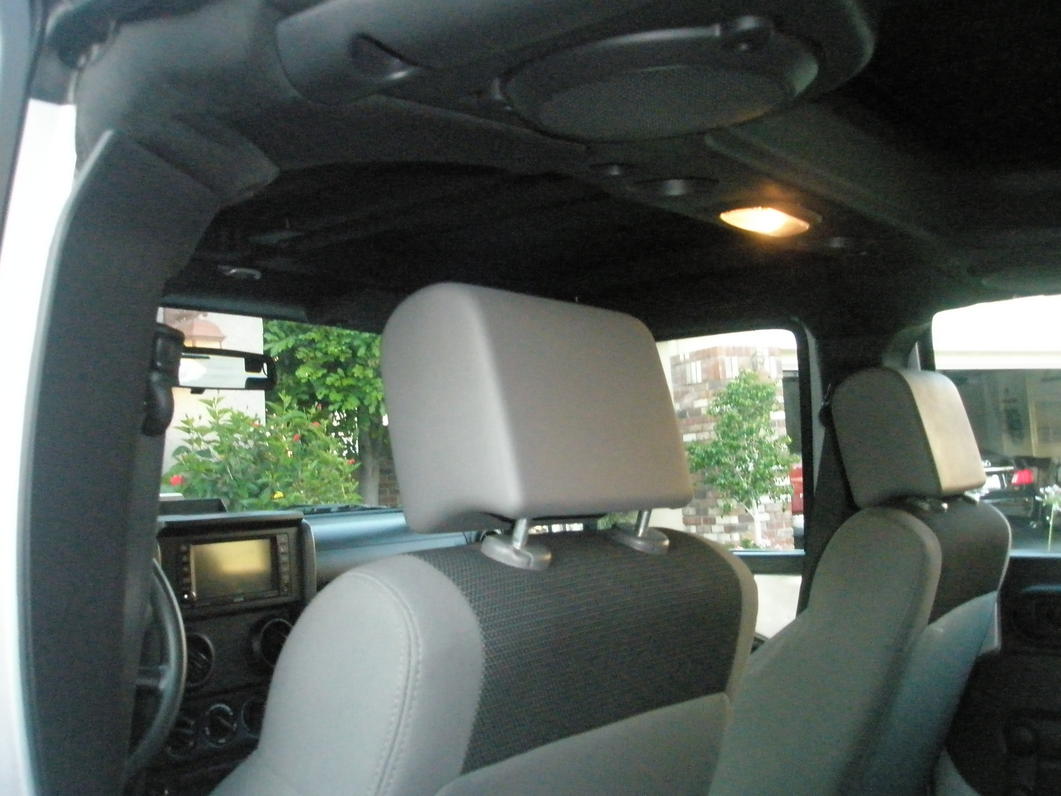

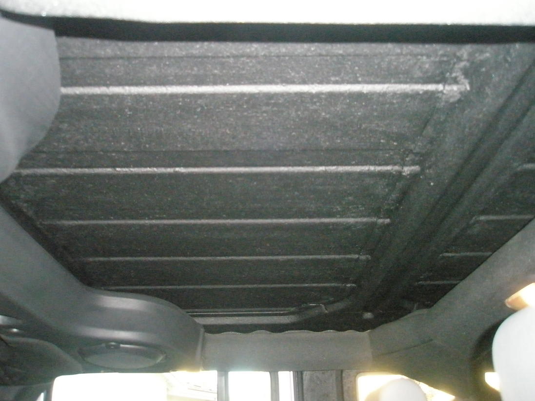

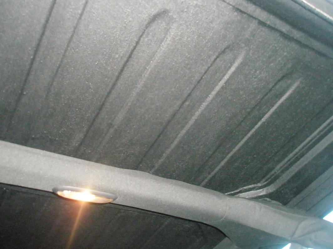

Default Dupli-Color
I used the Dupli-color roll on bed liner. I figured it would be thicker than the spray on. I didn’t notice any temp difference. But it does look way better than the white!
