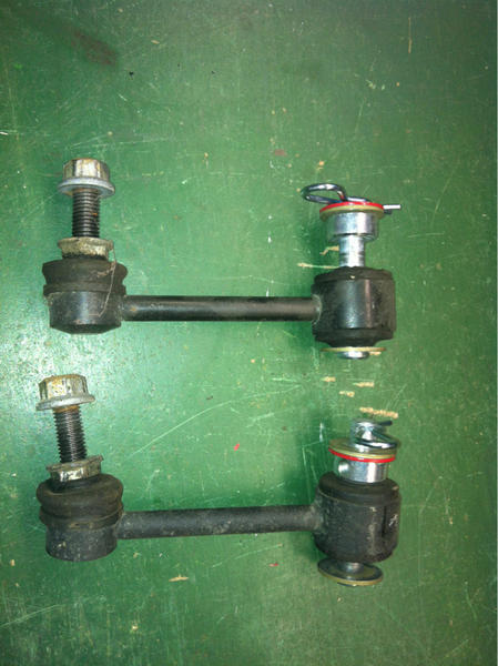

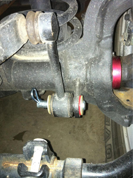

I made a set as well but used the next size up clevis pin, yes it was a few thousands to big but just like you I did not want it rattling around. I used a drill bit the size of the new pin ( can't remember exact size) and bored out the sleeve in the bushing. It takes a lil bit and you have to be careful not to get the bushing to hot, but once your done the clevis fits like a glove. The other thing I did was also buy some spacers (2 per side) to take up the gap from the end of the link to the cotter pin. Hope this helps. My pic does not show the spacers this was right after I installed the pins.
Thanks bro. I had considered something along these lines but was unsure. Glad you were the Guinea pig. Lol. Thanks for posting your pic as well.
