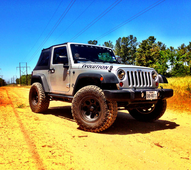

I use a rough country 2.5 coil/shock lift. Rides like stock mostly.
