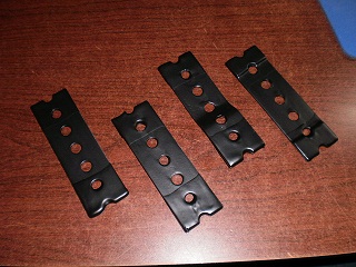

Ok, so i'm building my own lift. I'm running a 2" BB right now and decided to get rid of the spacers and go with springs and such. The springs I got (from a member on here) appear to be Rubicon Express 4" but from a 2dr. That's is ok with me since mine is a 4dr and I don't want 4", but about 3" is perfect. I did the following:
4" front and rear Rubicon Express Coils
Tereflex front and rear bumpstops
Front adjustable trackbar
Rear trackbar relocation bracket
I made my own front and rear brake line relocation brackets (I can put up a write-up if it won't step on any company toes, here's a pic)
Rear brack line extension (if needed)
