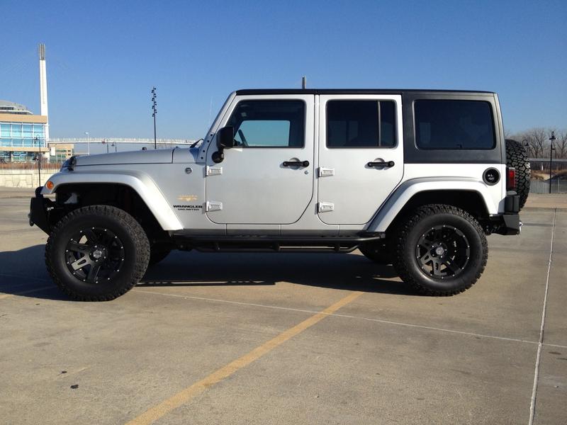

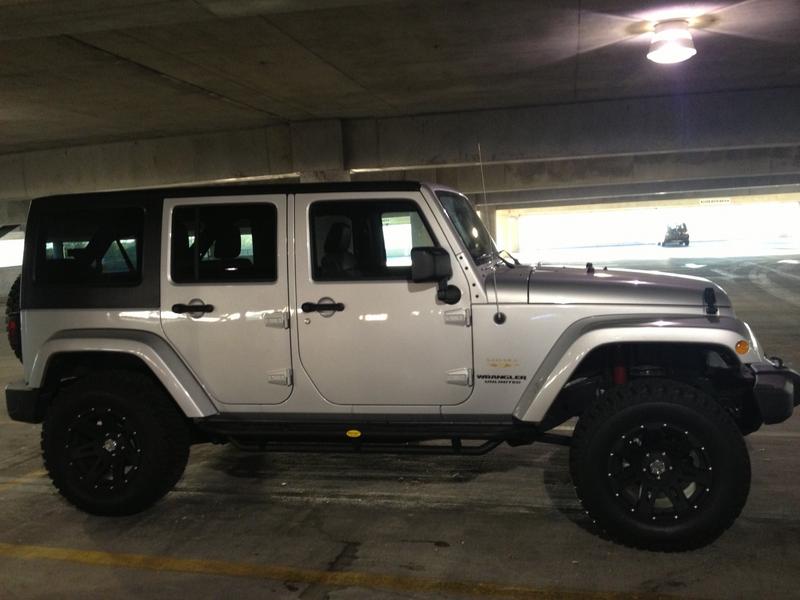

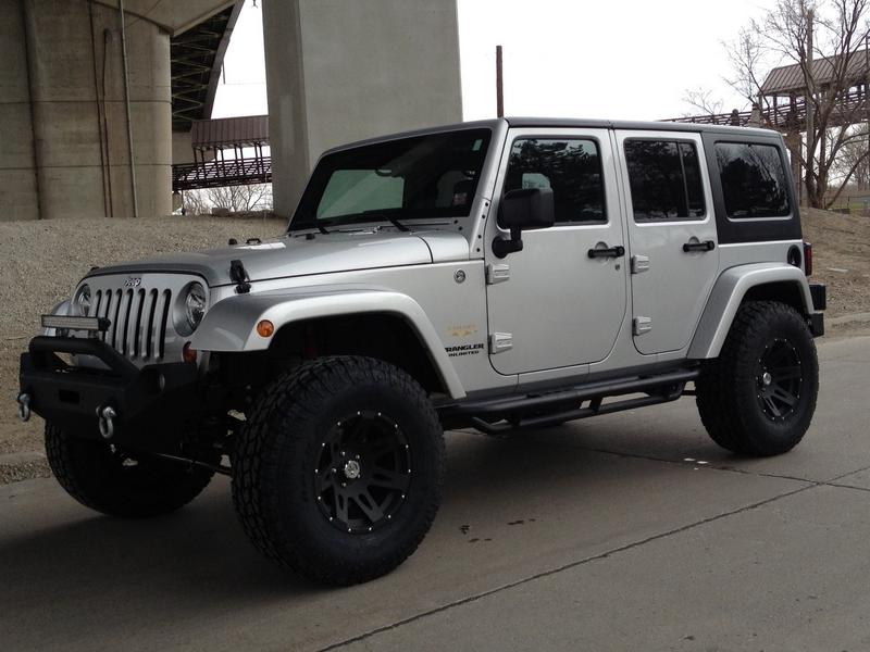

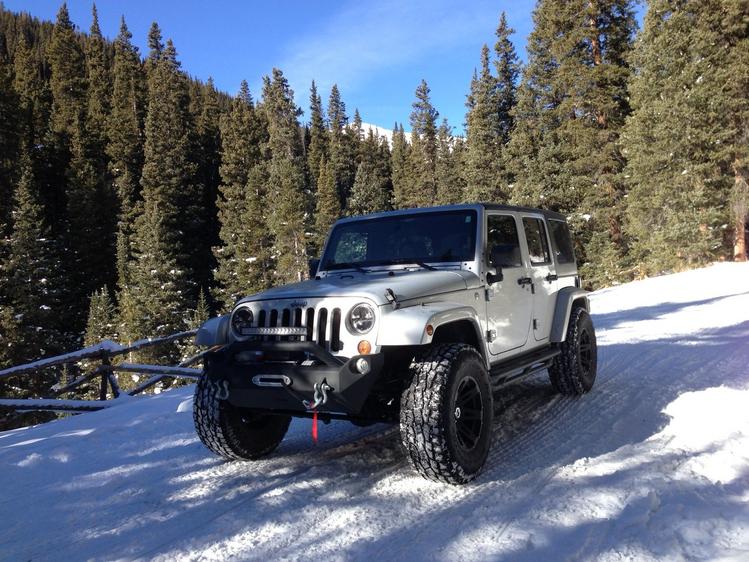

Last time I posted here I had just put the lift on. It's been a few months and since then I've added an aftermarket from bumper and a winch... so about 145lbs total (85 for the bumper and 60 for the winch), oh and 35's. There's a reason Rancho makes this lift the way they do... if it was level from the start with a stock bumper, it'd sag once you add (like many of us do) a real front bumper and a winch.
In my opinion the ride quality is actually better with the heavier front end. The shocks have more weight engaging them over whatever terrain you're on and you can feel them responding more making it, for me, a more enjoyable ride. I'm at 3 in the front and 3 in the rear for daily driving. Snow wheeling in CO last month I dropped them to 1 and 1 and they were great. Definitely recommended them.
Here's some perspective: 33s lift stock bumper / 33s lift a.m. bumper / 35s lift a.m. bumper / 35s lift a.m bumper winch
