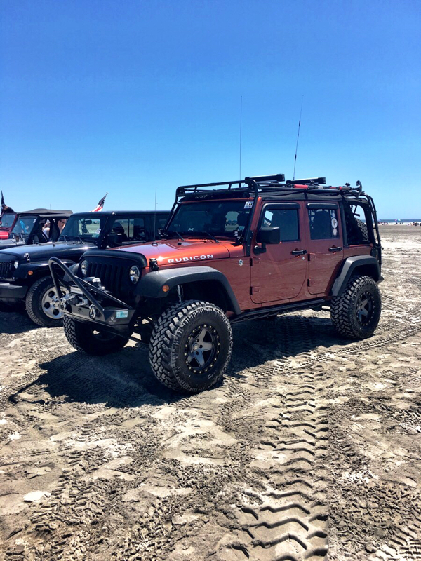

AEV Dual-sport 3.5 RS. I have that on my 2014 JKU Rubicon. Excellent. My jeep is heavy, with Gobi rack with attachments on it such as high lift jack and other attachments. Jeep drives perfectly and performs perfectly for an expedition type jeep.
Old Mar 6, 2017 | 02:35 AM
coolhand129's Avatar
Joined: Jun 2014
Posts: 98

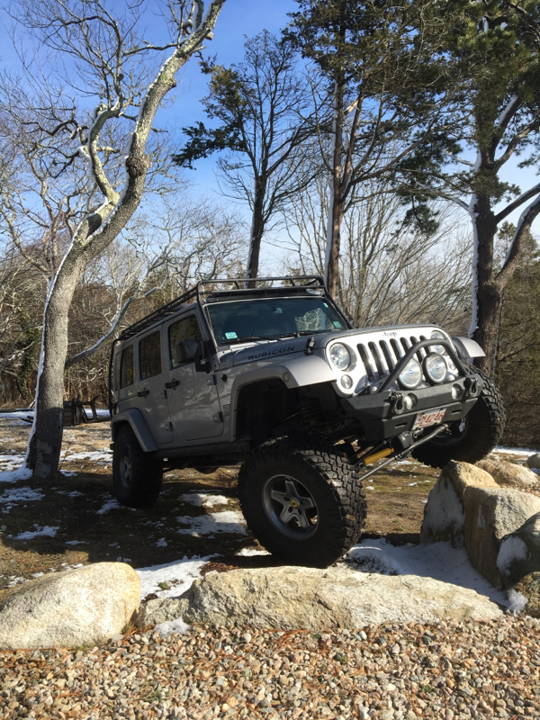

AEV. I have the 4.5 Dual-sport SC lift on 37" Nittos, Gobi rack, Crawler Concepts front and rear steel bumpers, full skids, etc., etc... I also tow my 23' pontoon boat too. I've had this setup for 3 years with no sag or lack of performance. I love my rig! Click image for larger version
