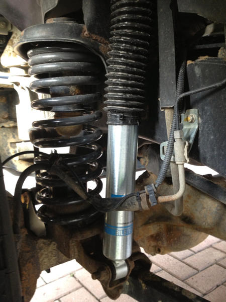

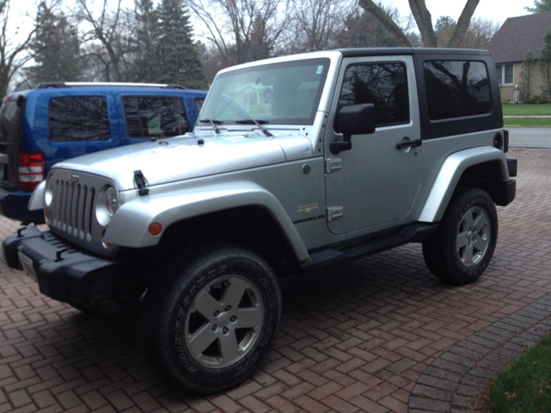

I apologize if this has already been posted, but I just received my 2.5 inch Dualsport AEV lift and noticed the driver side sits 3/4 - 1 inch higher than the passenger. Is this normal? has anybody experienced this? if so... what should I do? do I do anything? the ride seems great to me.

unfortunately I only have the passenger side pic now. let me know if you need more pics.
thanks for the help!

Old Apr 29, 2013 | 02:10 PM
blue project's Avatar
Posts: 1,531
From: Cape Cod
That doesnt seem right has both front springs are the same length. Are you sure both springs are seated properly?

I have that lift installed, and I measure before and after and all 4 fenders were the exact same height, and I gained exactly 2.5 inches of lift at each wheel.
Was both sides the same height before the lift?
Agree one of the front springs it's not seated properly, probably the side that's too tall. Another possibility is if you torqued all the control arm bolts while it was still off the ground. They all need to be torqued while the jeep is sitting on all 4 wheels or you could get some binding.

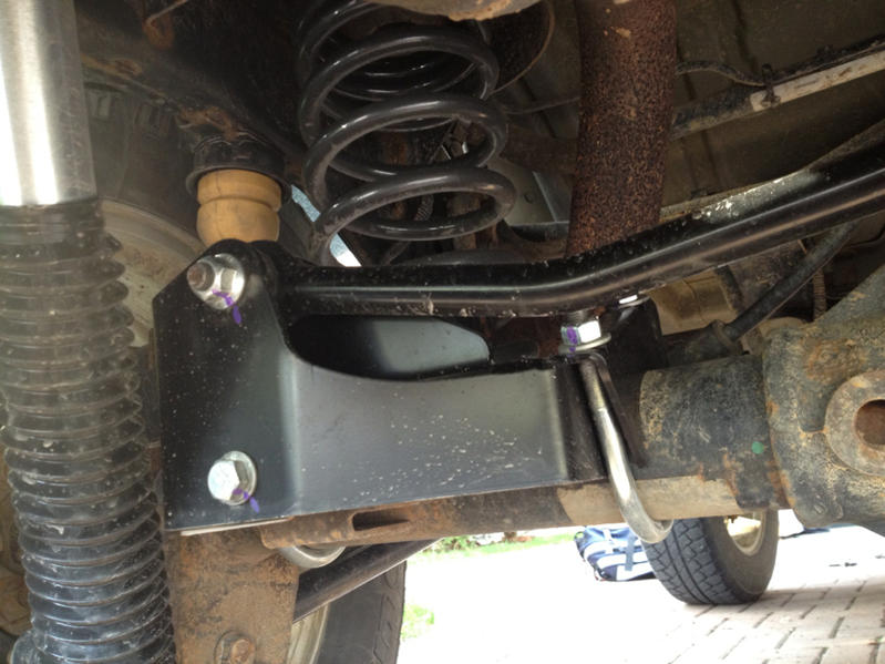

I don't see anything wrong with the seating.... does anybody see anything fishy? please help!

Old Apr 30, 2013 | 08:53 AM
Nbjeep's Avatar
Posts: 164
From: 1/2 tank of gas from Moab
How about the rubber isolator above the front springs? Is one flipped or missing?
