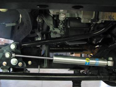

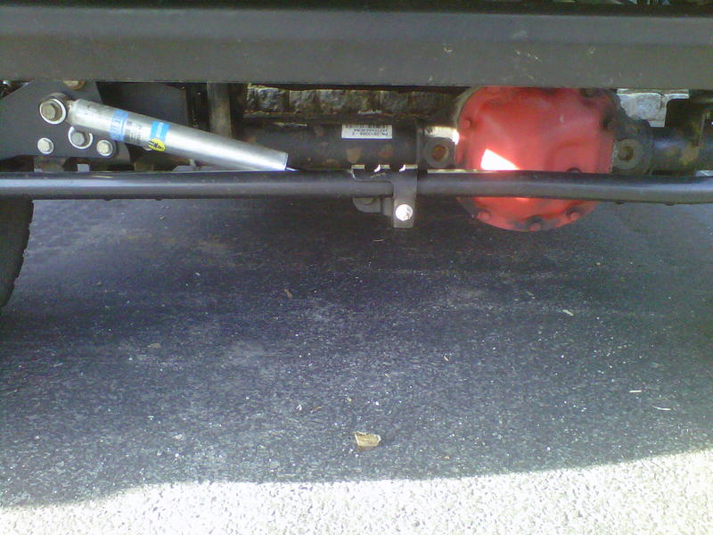

So, I had my new AEV lift installed 2 weeks ago and while I love it, something about the steering stabelizer just didn't look right to me....and after doing my research and looking at other pictures on the AEV site, I think there is something wrong.
It started off with me noticing (or thinking) my tie rod is getting bent up a little right in the middle where the tie rod and steering stabelizer mount meets, see below.

Now, after looking at the AEV site and what the picture shows in the instructions for the steering dampener and bracket, it seems like the person who intalled it DID IT FRIGGIN WRONG!

The bracket in the middle of the tie rod should be flipped to the TOP and the stabelizer should be reversed (the actual thicker tube should be attached in the middle of the tie rod, not the other way around). You can also see how much of an angle the stablizer is currently sitting as supposed to the way it SHOULD look, more parallel to the tie rod.
I know you can't really tell in the pictures, but like I said....it seems to be bending my tie rod upwards towards my bumper. I'm quite pissed if you ask me. That's a quick fix (or atleast I hope), but who the hell does that?! I mean, it clearly shows it in the instructions....
Is this something that can screw up my front end if it's not flipped and correctly immediately?

I would fix it ASAP.

A couple wrenches and 15 mins will fix that. Do it immediately.
Also, if something as simple as that is messed up, everything else should be double checked, retorqued, etc.
