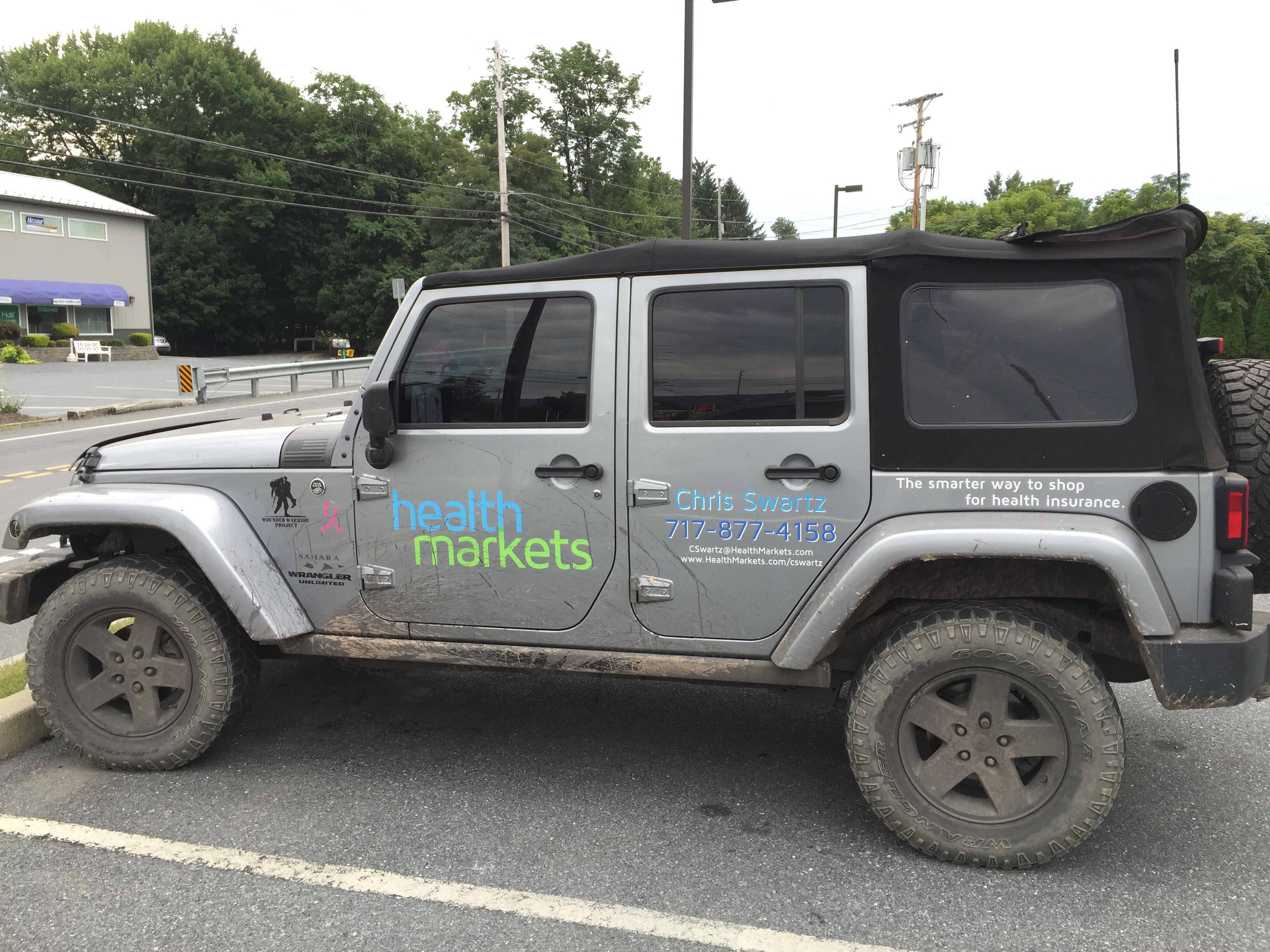

Old Aug 9, 2015 | 01:42 PM
aubreys dad's Avatar
Joined: Aug 2008
Posts: 98
From: New Freedom, PA
Default Pic
ID:	620929Click image for larger version

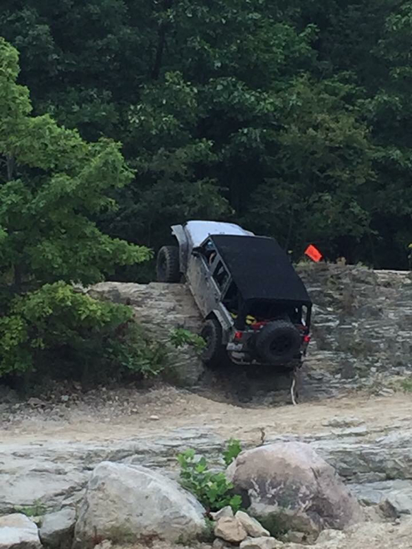

Old Aug 9, 2015 | 01:44 PM
Joined: Aug 2008
Posts: 98
Default Roy from our group
ID:	620930Click image for larger version
ID:	620930gives an idea of who we were running with.

Sounds like your issue was your breakover angle, not approach angle, so a front bumper is of no consequence and would be a waste of time given your stated problem.
Any pictures of you when you got high centered?
