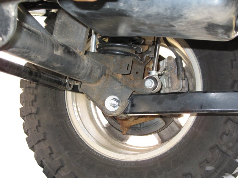

Just checked BDS's website. I'll assume you have the $750 3" lift and not the expensive one? If so, it comes with cam bolts. Crawl underneath and verify that they are both set to roughly the same spec. The installer may have even painted a line over them so you can easily see if one has slipped. (this is the bolt where the front lower control arm connects to the axle. You will see a normal bolt, with a big washer that is offset to the side instead of being centered like a normal washer. )
Found a pic from a BDS writeup.
And a DIY alignment writeup, which will show you how to center the steering wheel and check the toe.
