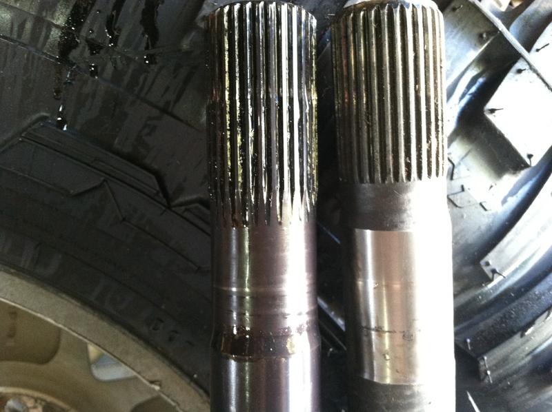

Could be the seal but could also be this:
Axle on left is a 10 factory and the one on the right is the stock axle. Note how the Seal race goes all the way to the teeth on the stock axle but on the 10-Factory it is about 1 1/2 inches from them. The diameter of the stock axle was about 1/16" greater where the seal was riding on the factory axle. This caused mine to leak pretty bad. I spoke with 10factory and they sent out a new axle with the correct machining.
I guess they had a pretty big batch of the passenger rubicon d44 axles get out with this problem.
Anyways pull the axle, if it looks like the one on the left, call 10Factory, if it looks like the one on the right, your seal is bad.
Attachment 485704
Awesome! Thanks for the heads up on this. Pain in the ass if this is what caused my issue!

Did you have to replace the seal as well or did the new shaft fix the issue?
Old Aug 6, 2013 | 08:29 AM
Rob 12B1P's Avatar
Posts: 1,470
From: Bakersfield Kalifornia
The new shaft fixed it for me.
