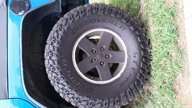

Have 37x12.50x17 on my jk with a 3.25in lift Cooper Discover pro stt. Love them!
Old Sep 2, 2016 | 07:43 AM
jeepjkgrrl's Avatar
Posts: 282
From: Jersey Shore
