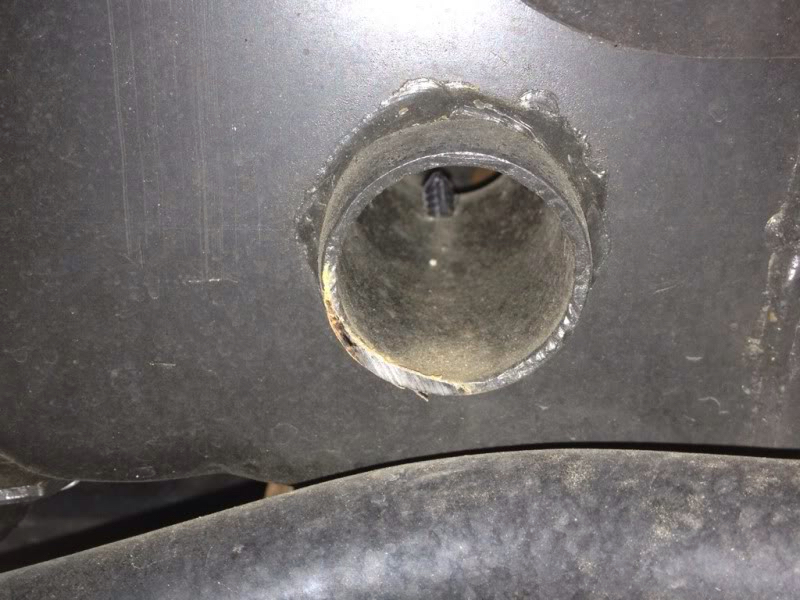

You check your from crossmember tube? I bet your swaybar is catching on it.
(See pic). On a rubi - your sway bars go up and down with the suspension travel since you don't manually disco sway bars and that stupid tube is about an inch longer than it should be
