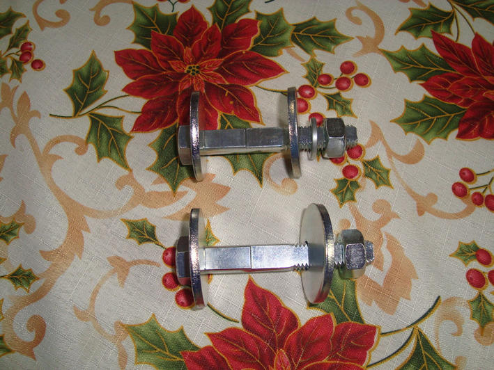

Is it possible the bolts on the floor are the old control arm bolts/washers not cam bolts? I think you'd actually be better off in the long run if they didn't install cam bolts, adjustable control arms are a much better solution.

Cam bolts are never a good idea on a off-road vehicle. BTW welcome to the forum

Well I am going to have Ryan from Rough Country call on Monday to ask if they tightened the bolts on the lift or on the ground. Ryan told me the only reason they would need cam bolts is if they could not get the caster right while aligning it. Anyways I am attaching a pic of the bolts not used, they look like new bolts to me. Thanks for the welcome. I come to the site a lot, but just never really post.
Those are cambolts.

Well after what I have read about cam bolts, I am glad they were laying in the floor and not installed.

Also, that lift comes with new 'fixed' lower ca's to adjust the caster, there should have been no reason at all for cams!!
It comes with a pitman and a trackbar drop, make sure 'both' are installed. If only one was actually installed, the geometries are off, and...
With fixed arms and brackets, there was nothing to 'align', you wasted money to have them re-center the steering wheel.
