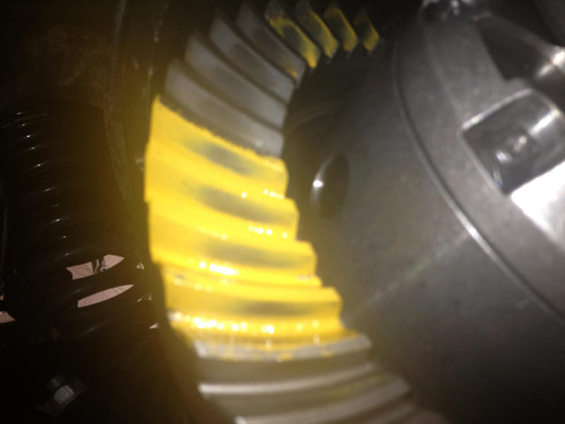

New 5.13s in Dana 44 rear. Would like some opinions on this pattern
ID:	454112   Click image for larger version
Old May 4, 2013 | 09:37 AM
shabbernigdo's Avatar
Joined: Nov 2012
Posts: 1,104
From: missouri
Looks pretty good to me.

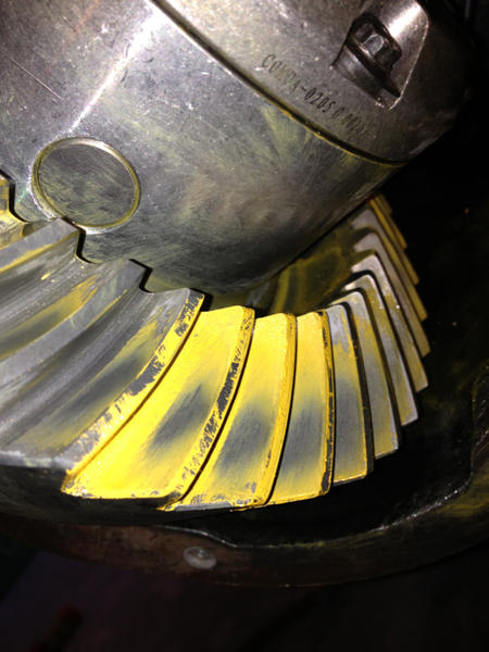

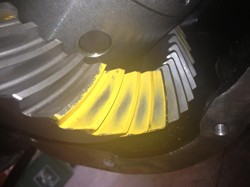

Ok, pressed all the final bearings on and have backlash of .007 and this is the gear pattern. Anyone think this looks ok?
ID:	454963   Click image for larger version
Old May 6, 2013 | 04:07 PM
JK_Crawler's Avatar
Posts: 193
From: McDonough, Ga
Ain't going to get any better, put down the tool and grab a beer
Old May 6, 2013 | 04:25 PM
havochaos's Avatar
Posts: 205
From: Lubbock, Texas
X2 time to close her up.
Old May 7, 2013 | 06:16 AM
JKred's Avatar
Posts: 1,467
From: Torrington CT
Agreed, pattern looks good. I'd run that, nice job!
