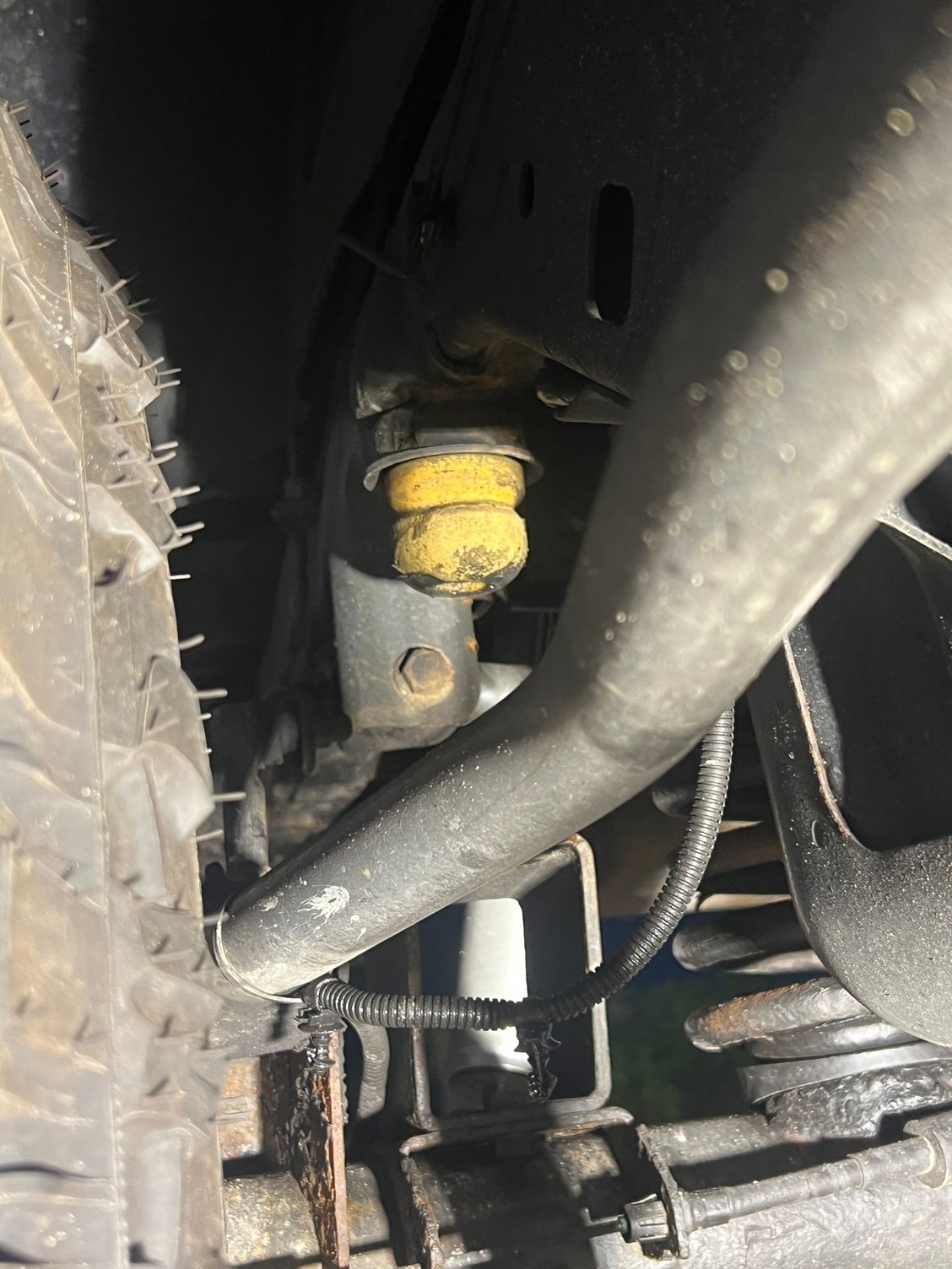

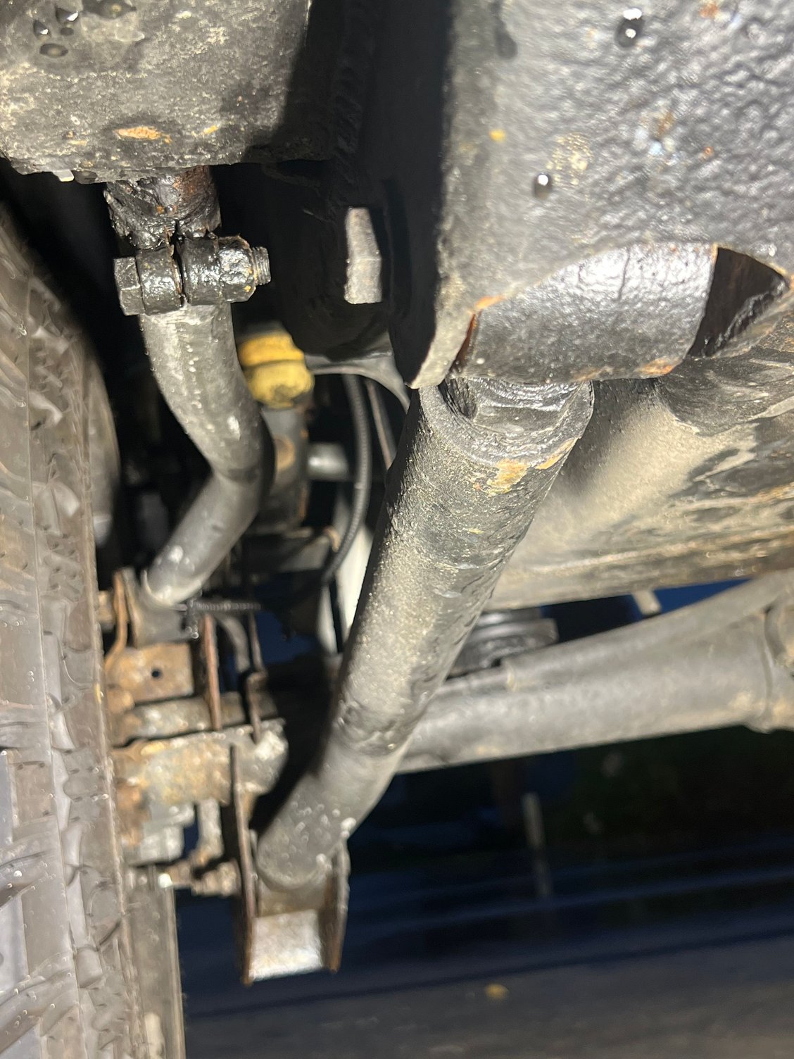

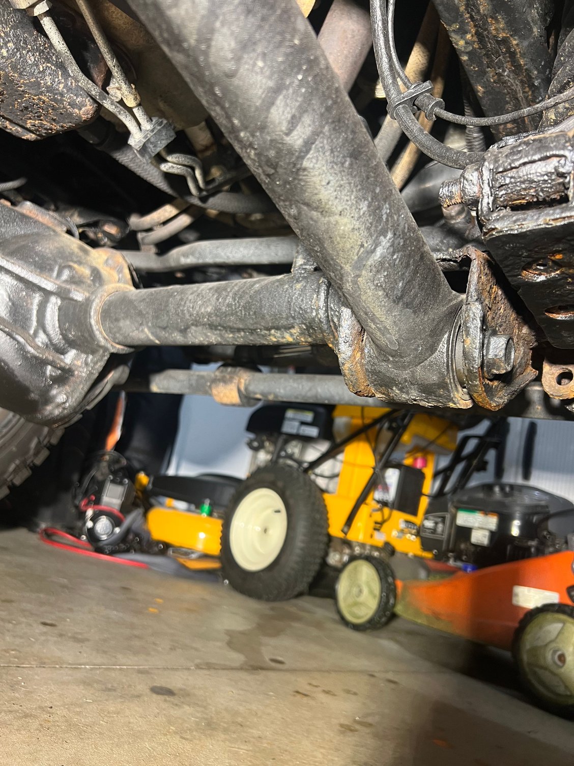

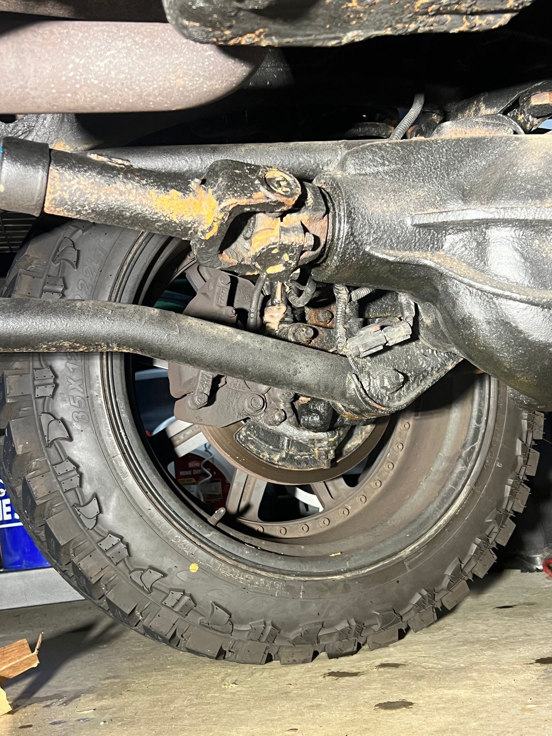

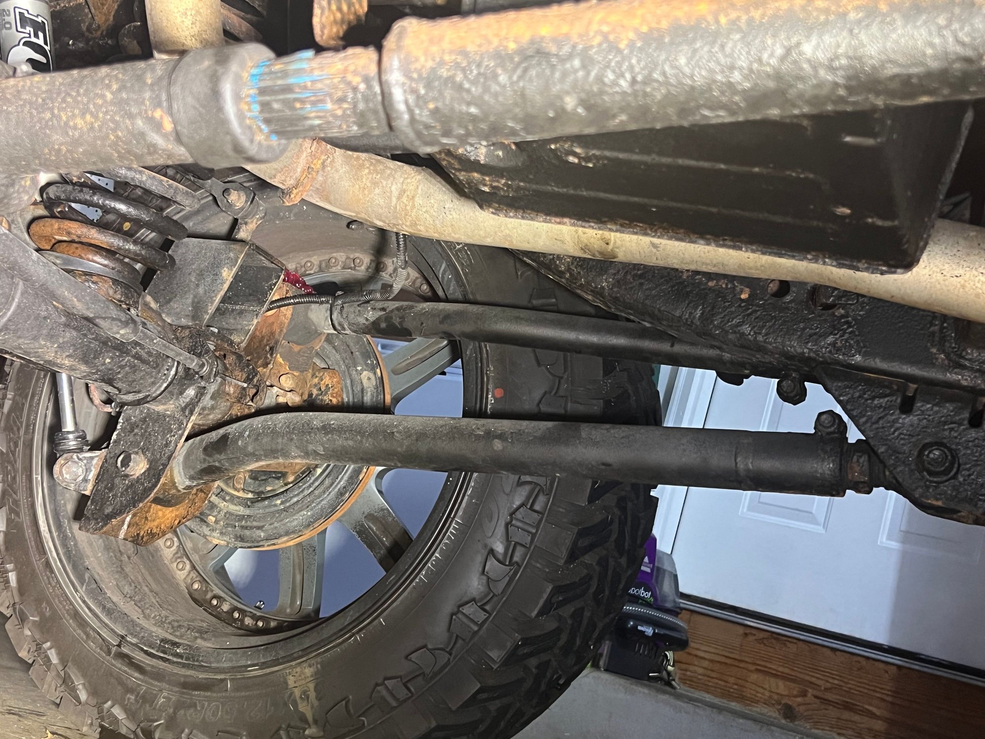

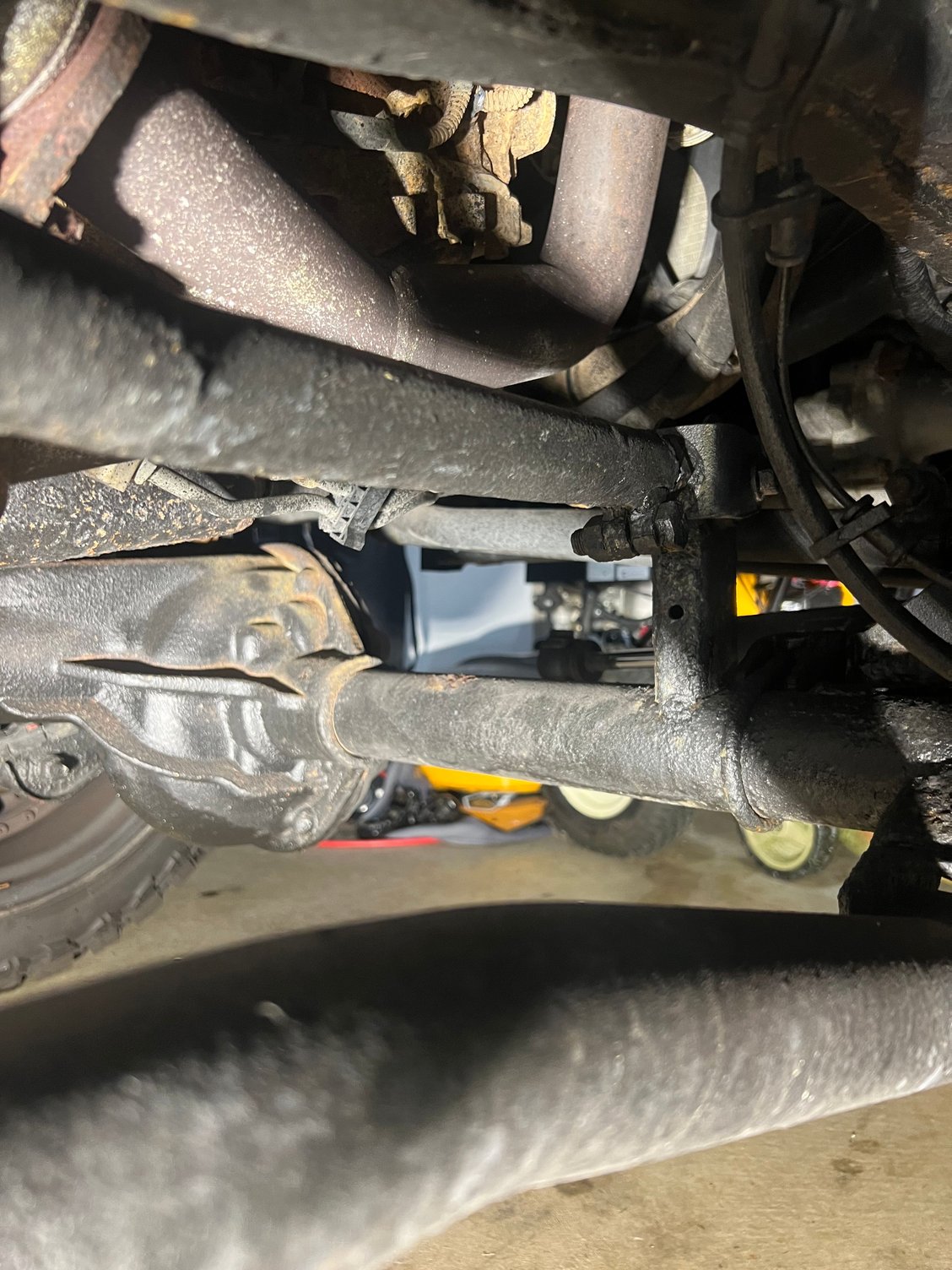

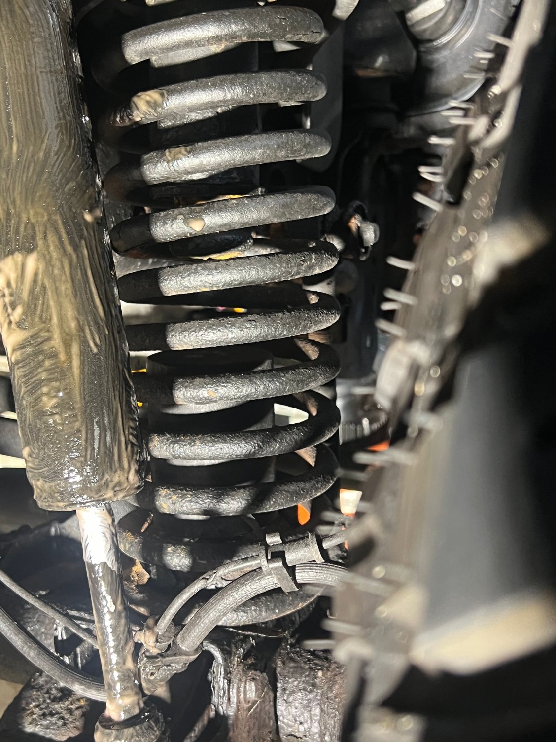

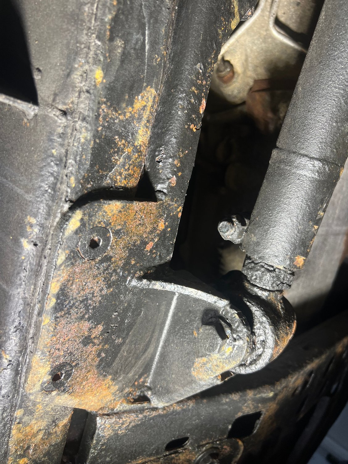

I bought a lifted 2015 Rubicon where the previous owner or dealer sprayed undercoat on everything. The bushings on the control arms need replaced and I don’t want to buy all new. Can anyone help identify what lift kit is on this? I cannot find any markings whatsoever. It does have Fox shocks. In some spots it looks like the control arms might have been gray.

Those look like Synergy arms to me with their double-barrel adjustment sleeve and pinch bolts.
I think you are right! Everything seems to match their stuff! The only difference I see is my arms have grease zerks but reading their website it seems they switched to maintenance free poly.

Yes, several years ago they changed to a DDM bushing which is a nicer option, though they are not compatible with the joint housings you have. Several years ago you could still get the poly sides for your joints as I think Daystar produced some, but I'm not certain they still do or not. You might contact Synergy and inquire about the poly bushing replacements, but it's been quite a while now since they changed and they simply may have stopped supporting that old version.
