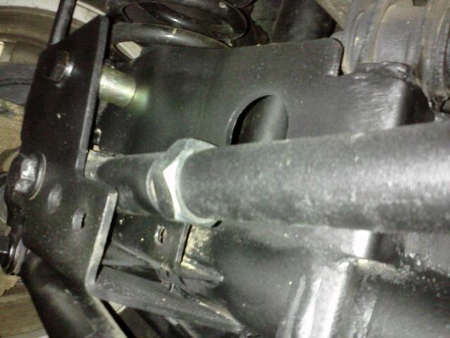

I could be wrong, but when I put on the front track bar bracket, the instructions called for bolting and welding which is what I did. The of did by include he steering stabilizer bracket, which I think should have. The new location of it is shot half an inch lower...no worked though...we found a part that my buddy is going to custom fab and weld where their bracket should go! Seriously stout products!

I guess I could have put a pic up!?
