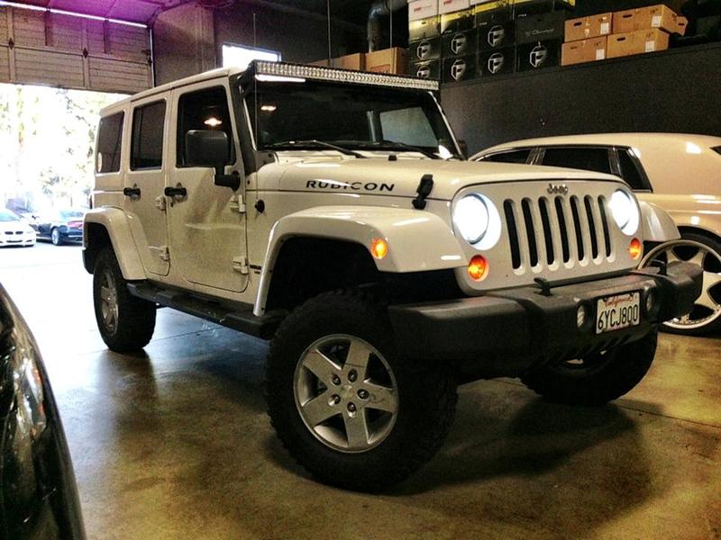

I just got my 2.5 RK Kit on my 2012 JKU Rubicon yesterday and was wondering is there anything I need to ask them to do? Any camber specs or anything like that? Rookie to the game and wanted some help. Any recommendation would help. Its a daily driven car and I will have 35's on it in the next month or so...
