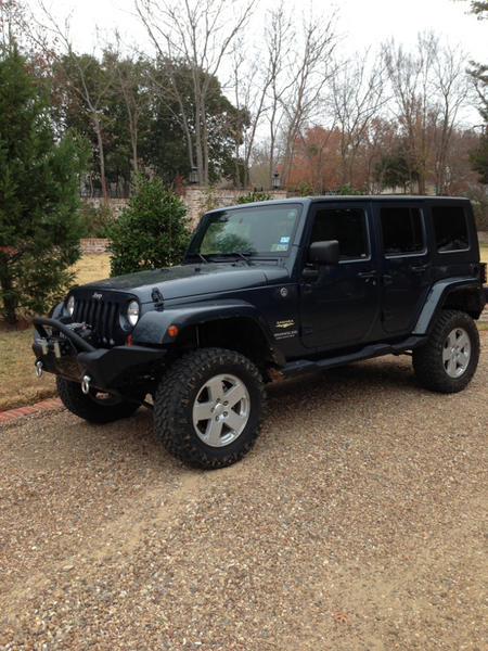

Originally Posted by matprovo
Just curios but what lift?
Zone offroad 4" lift
