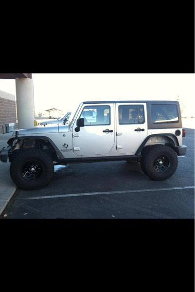

Teraflex leveling kit with 35x12.50 nitto trail grapplers
Only with flat fenders but it's a nice combo. I have the leveling kit with 34" nittos and they rub the back fenders to the point were they broke a few of my fender clips. Needless to say the fenders flap aeound now. Im upgrading to an aev 2.5 lift soon!
I Just chopped the fenders about a month ago i was running the leveling kit and 35 set up way before that. I have the 18/59 springs on there but your right with a jeep full of shotguns and duck decoys i was knocking fenders off and rubbing my rails. But for everyday driving it was great. Also check out clips and fasteners dot com and they sell the clips for the fenders 8 dollars for 30 clips(pm me if you need a part number).
