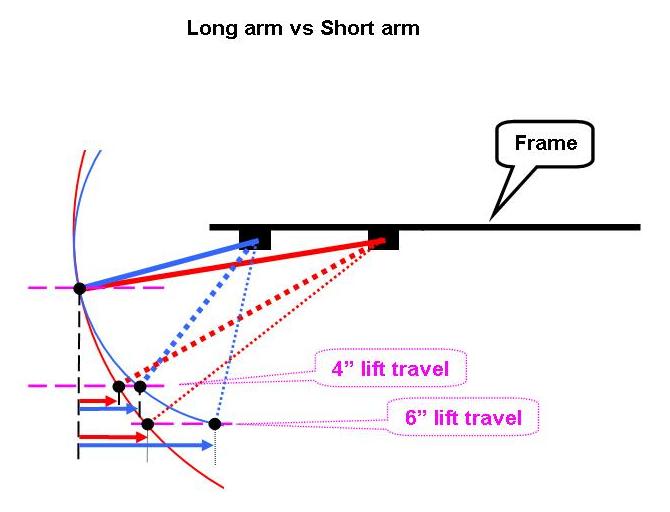

Most long arms are more exposed and therefore more vulnerable (Unless you pick less exposed long arms such as the Rock Krawler).
With long arms, the wheel travels along a flatter and more vertical arc, and the arms stay more horizontal, from zero to maximum flex, therefore, they're supposed to deliver the force more to the coil/shock and less to the frame.
I like relatively soft ride and hoped that long arms would deliver that.
Before making my decision, I had compared 2 similar Jeeps, one with short the other with long arms. Both had 4" lifts, the same coils & shocks and even similar wheels.
I expected softer ride with the long arms, but there was no real difference, on or off road.
I'd say that long arms are a must for 6" lift or more, but do not worth it up to 4", where, according to my experience, the advantage of long arms is more theoretical than a real one.
The following (exaggerated geometry) schematic sketch, demonstrates the difference:
Name:	LONG ARM vs SHORT ARM --- 4 vs 6 inch lift ###.jpg
The choice of shock/coil combination (mainly the shock valving) is what would make the big difference in road & offroad behavior.
