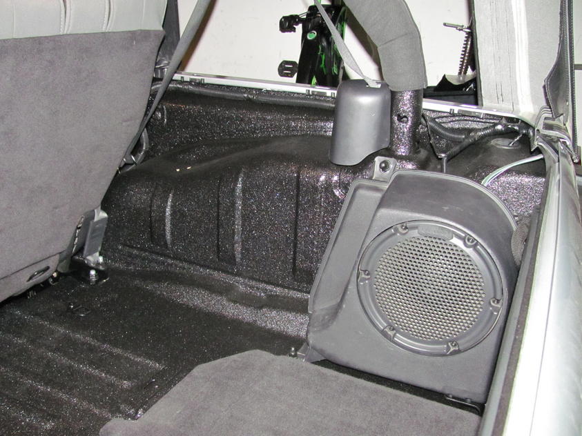

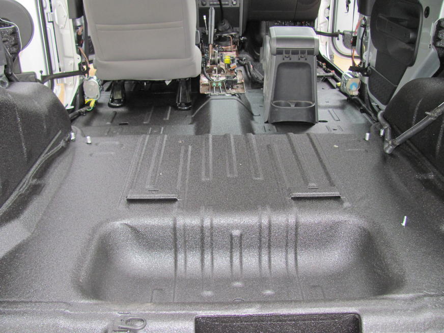

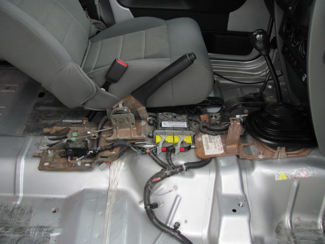

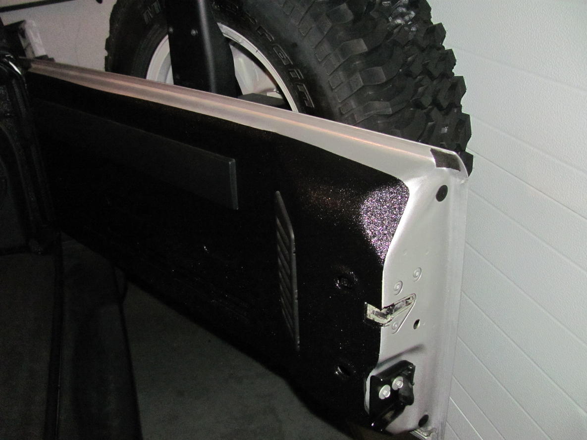

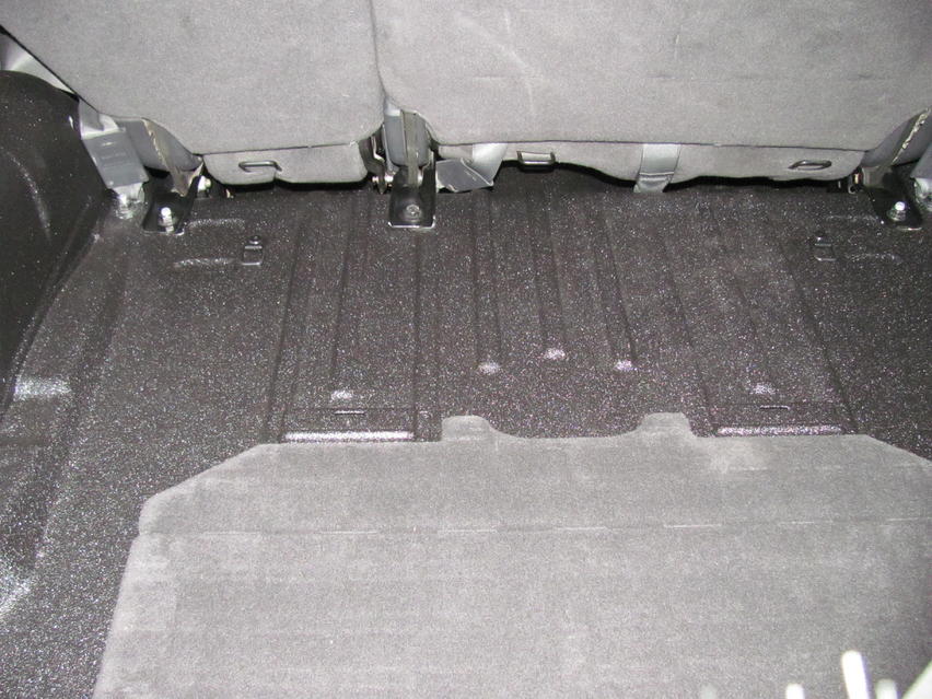

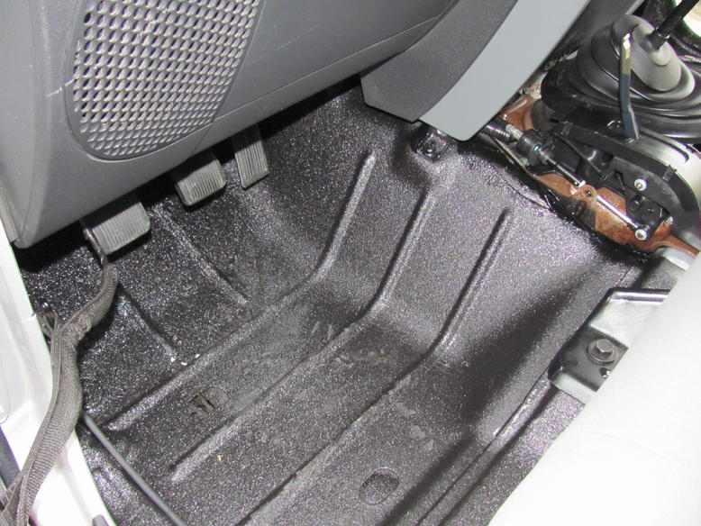

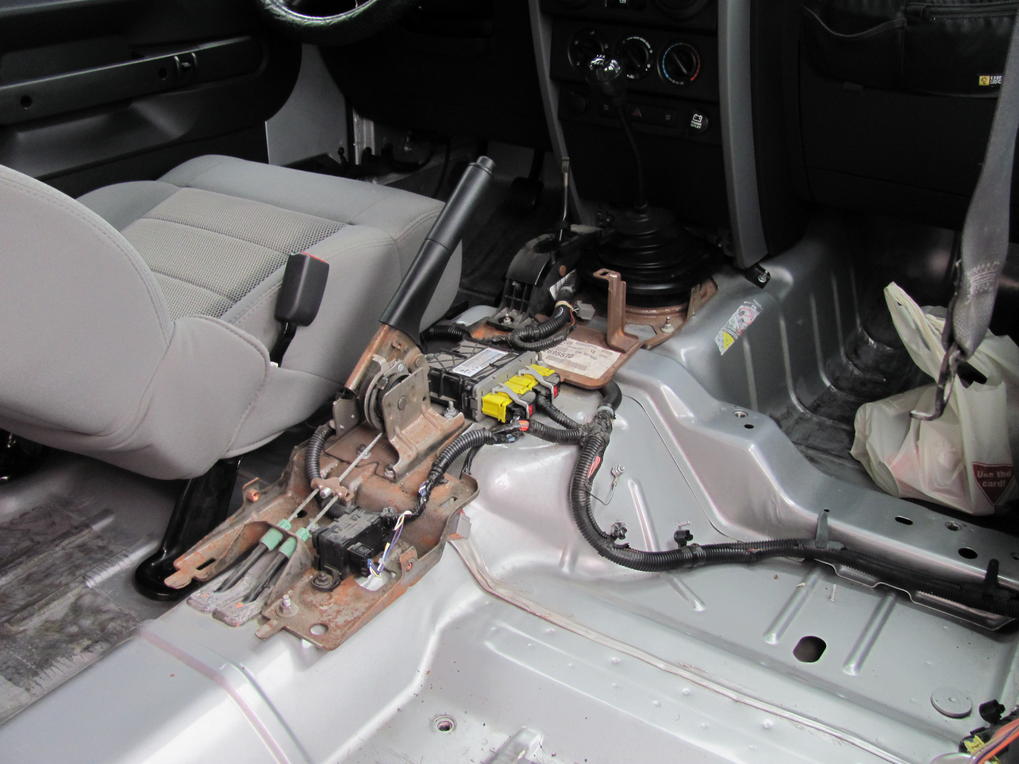

i left the seam caulk and have had no issues.....just make sure evry square inch of painted surface is scuffed up otherwise it WILL peel...ask me how i know!
some pics for ya!
